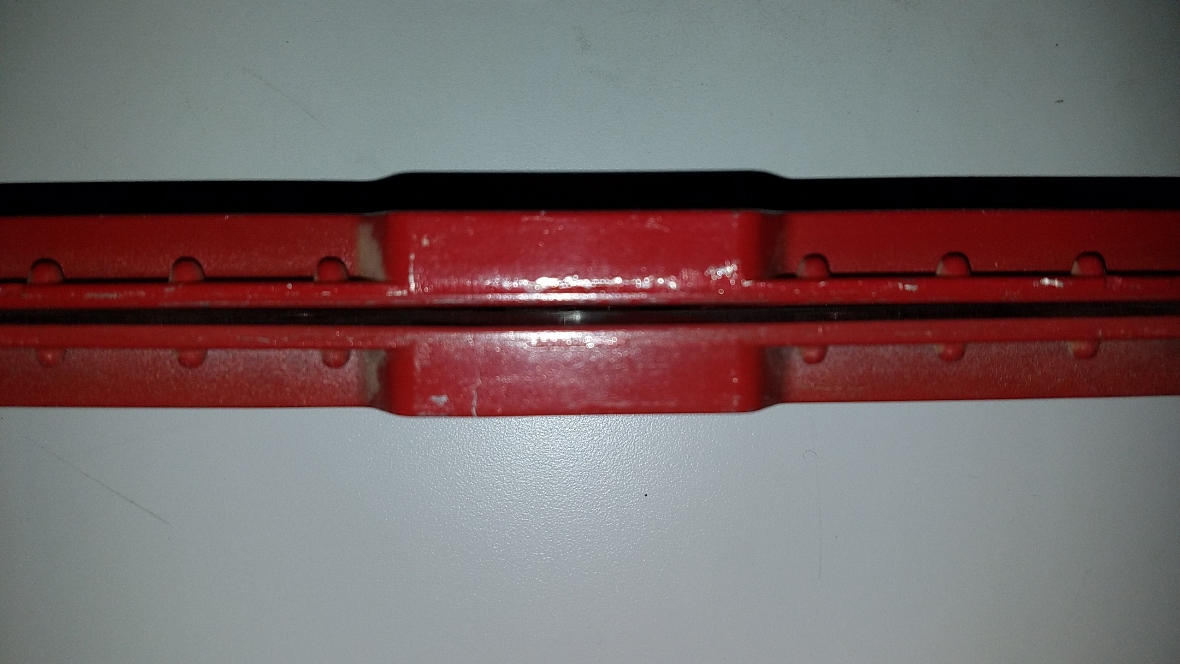

Where is it higher? The insert is not designed to lay flat but rather have arc to it so that the two ends are higher then the middle until you tighten the screws. This looks a bit odd so it is possible that someone thought they needed to "fix" and bent it the wrong way?? (That would be high in the middle.)

Yes, you must do what is necessary to make it fit but that should not be a serious task. As has been said, there is an intention bow in the insert (the ends being higher than the middle. I would think you could see that bow if you simply laid the insert on a flat surface.
Without the inserts, run the bolts down into the table and back out. This should clear the threads as well as the hole.
You said something about cracking it. The intended bow is very slight. Securing it is not going to crack the insert.
Crack the insert, hmmm. Do you have plastic or metal inserts?
Not the best picture but I hope this shows how small the bow actually is. Two metal inserts face to face.

I understand the bowing of the insert. It was readily apparent when I 1st set up my 500 a couple of years ago. It worked perfect on my 500.
I was surprised that tightening the screw did not draw the insert dow flush with the table on my 510. The insert was fiscernibly higher than the table surface.
The cracking comment was supposed to be humorous. The idea being if previous owner pressed and stressed the insert enough to take the bow out of it and flatten it, then it might develop a stress fracture.

I think I will need to order a new insert. The insert is bowed on one side but flat on the other. When sitting in the recess the right edge is sligtly above the surface. The left side is flush. I suspect it was defective from start or suffered some trauma by previous owner. Probably the later. Duckman

Duckman wrote:I think I will need to order a new insert. The insert is bowed on one side but flat on the other. When sitting in the recess the right edge is sligtly above the surface. The left side is flush. I suspect it was defective from start or suffered some trauma by previous owner. Probably the later. Duckman
I be suspicious of the counter sink holes being too deep or the contact pads distorted..

The table itself looks fine. Also it does not bow like the pics posted by Dusty. Pretty sure it is the insert plate. Hate to drop $30 on a new one. Hopefully SS has some in stock. Duckman
