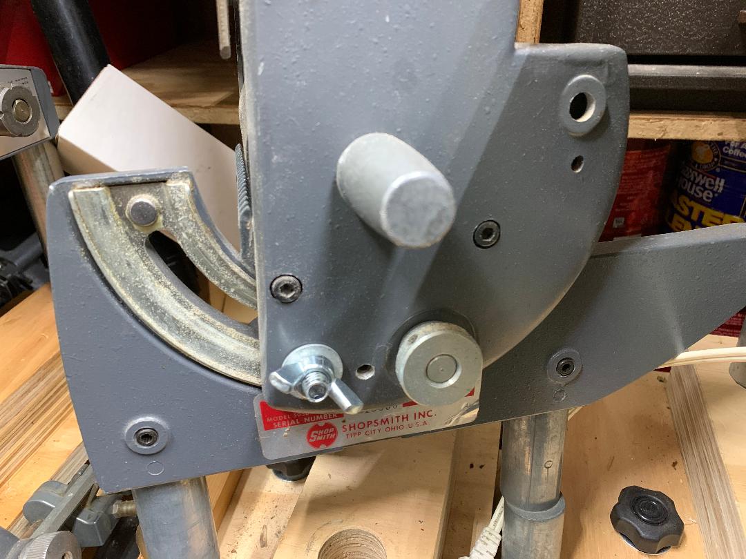

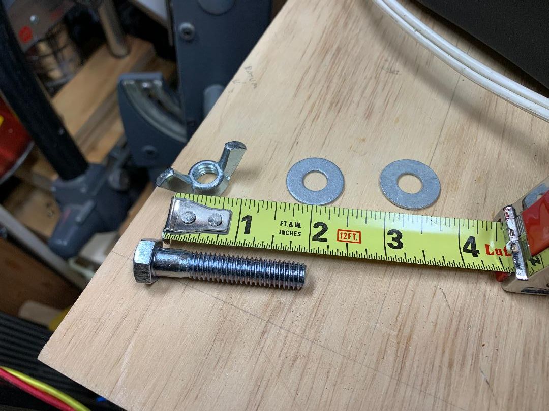

There is an additional bolt (#78 in the exploded diagram) that can be used to hold it firmly in position. :)
Re: Is this Normal for the 6" Belt Sander?
The belt sander doesn't have to do that.
There are two holes shown here that can be used to fix this.
One is used when vertical to some tilt, the other is for the other position. You need to add a 3/8" bolt and a couple of washers and a wing nut or other way to tighten it.
It goes like this:
Yes it does slow down quickly.

Thanks all y'all. I think adding the bolt is a good idea that also addresses the issue of shaft alignment. With the amount of movement i was experiencing there was quite a bit of variation in the shaft alignment.
