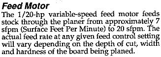

The feed motors on Shopsmith planers are indeed continuously-variable speed, Dick. That's one of the things that makes them stand out from lunchbox planers.
From the Pro Planer manual:
IIRC, the feed rate range on the Mark V mounted planer is somewhat lower, to compensate for a slower cutterhead speed.

Absolutely Dennis, but they still feed to fast for some work IMO. With the crank, you can just creep it through getting 1000's of cuts per inch which give amazing results.
Nothing wrong with them, I just prefer to have more feed control (control freak?( LOL)
