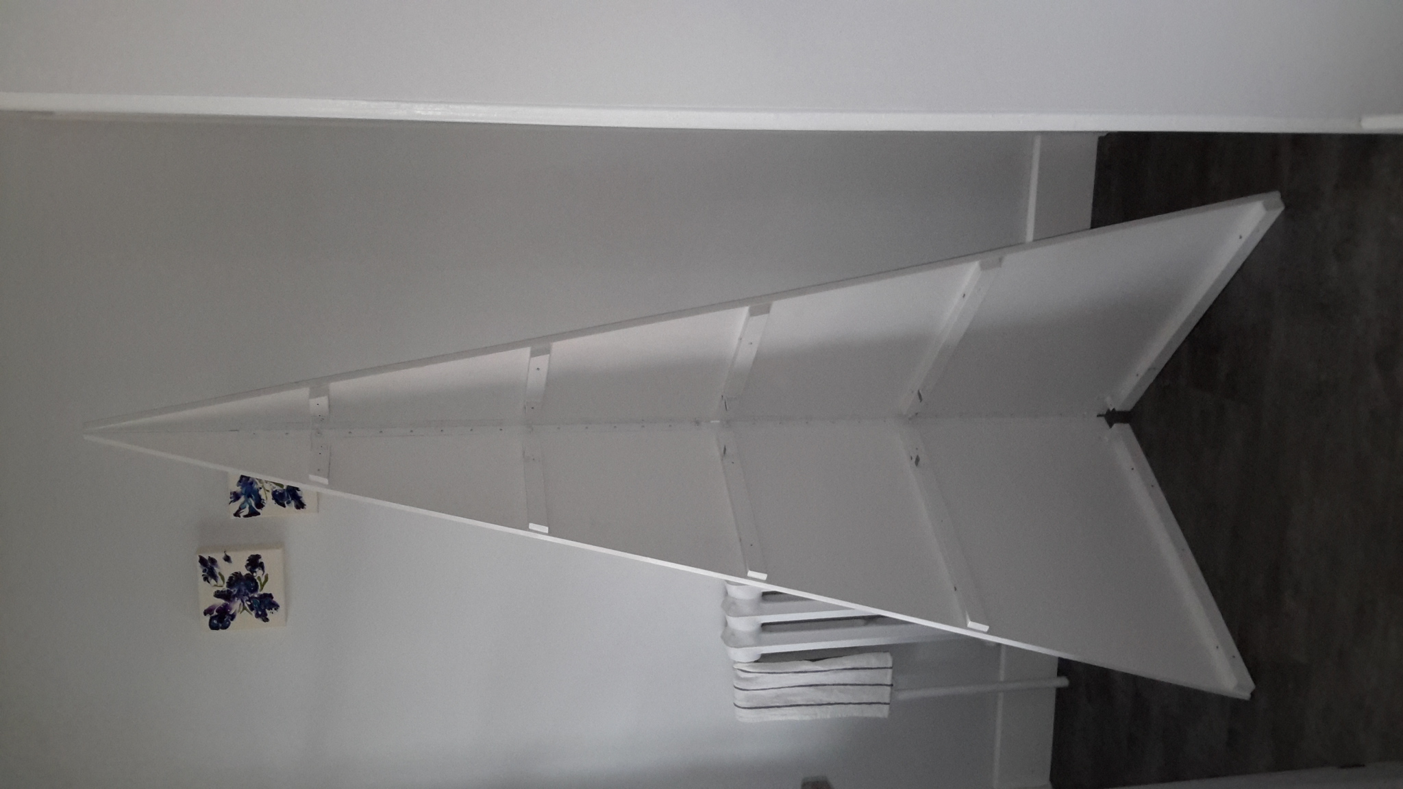

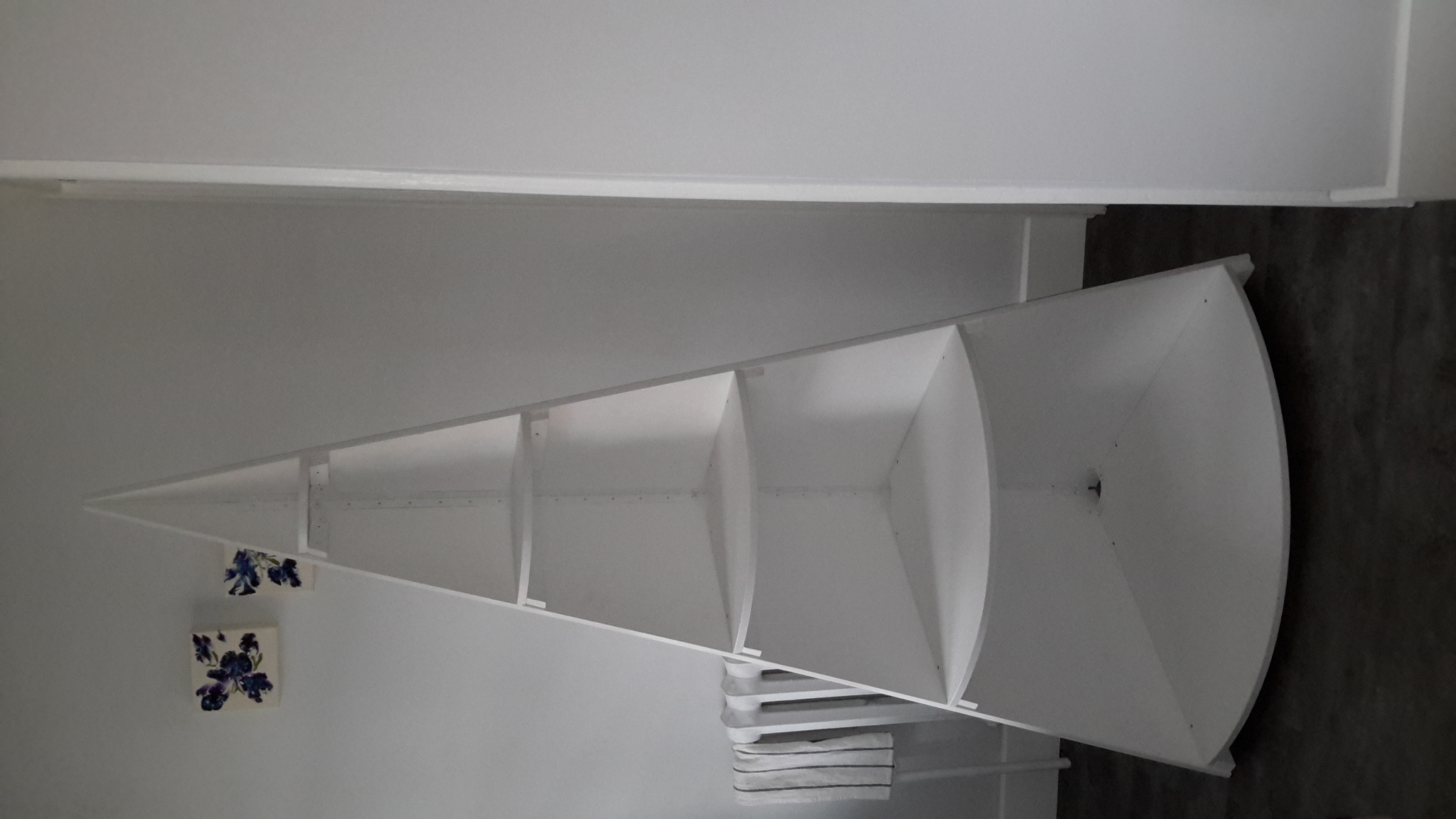

Finally finished the corner shelf for my grandaughter to display her Christmas village. I wanted to make it easy to remove the shelves and have it fold for storage but that proved harder than I thought. I put a piano hinge up the center so it could fold, but it can fold to 90 degrees to use as a shelf, but not the other way. It will go flat though so storage is easy once the shelves are removed.
To make the shelves removable, I drilled holes through the shelves and into the supports. The idea being that pins, I used wheel axles, would hold them in place and prevent the sides from spreading outward. However, I forgot the laws of physics. A little downward pressure on the leading edge caused the rear pins to pop out and the shelf to fall. Back to square one. I had to install small metal corner brakets on the rear of the supports to screw into the underside of the shelves. They can still be removed, but with a little more effort.
A half circle cut out of the inside corner of each shelf allows wires to run up the unit for the lighting systems.
I can't seem to find how to rotate these in the post. :confused:
More to come.

john wrote: To make the shelves removable, I drilled holes through the shelves and into the supports. The idea being that pins, I used wheel axles, would hold them in place and prevent the sides from spreading outward. However, I forgot the laws of physics. A little downward pressure on the leading edge caused the rear pins to pop out and the shelf to fall. Back to square one. I had to install small metal corner brackets on the rear of the supports to screw into the underside of the shelves. They can still be removed, but with a little more effort.
More to come.
John

Re the "lifting" shelves. One solution could be a rare earth magnet between the bottom/back corner of the shelves and the cleats. :)

Thanks for the information, especially the rare earth magnet tip. I actually have a bunch on hand but never thought of this. If I make another,( my daughter might want one), I will certainly try this method before resorting to screws.
