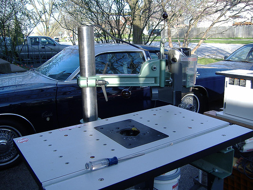

OK, I always assumed I had the OPR, but after further reivew, this doesn't have the same mount as what I was expecting. It surely wont mount to the SS tubes as there is only one mount bracket and it is about 4" in diameter. Take a look at the picture and let me know what this mounts to and what is missing to get it operational.....

I think that is the router mount for the old standalone OPR system. That system has it's own legs, table and vertical post that this assembly mounted to.
I sort of looked like a Radial arm saw but instead of RAS arm and motor assembly it had your pictured assembly mounted to the vertical column. There are pictures of a old OPR on the forum but I didn't find them.

Old OPR looks like this:
[ATTACH]2326[/ATTACH]
