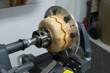

Here is the setup I used for holding the rings for gluing and aligning the glue joints on the segmented rings. I will try to post additional info as to how I created the patterns at a later date. I am going to have hernia surgery and may be out of action for a while.
chevron bowl glue up.jpg (11.5 KiB) Viewed 12607 times
Bill V
It does not seem to matter whether I hold the bowl with the jumbo jaws or the chuck jaws I still get the slap on startup.
