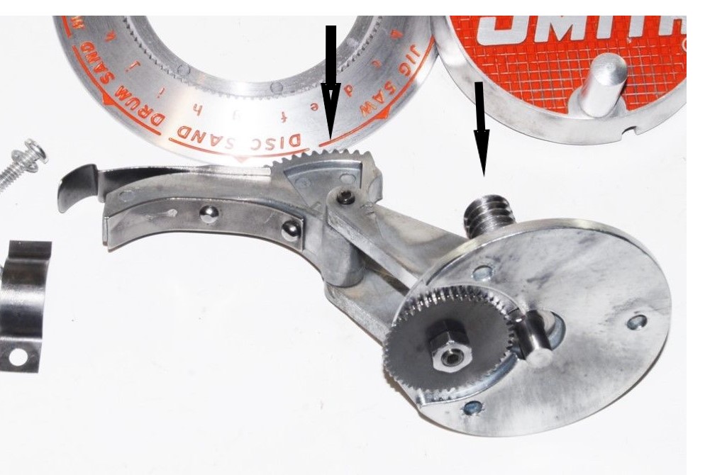

While you have everything apart check the Speed Control Assembly. Specifically the teeth on the porkchop and worm gear (see arrows in the picture below). Also check the teeth on the speed control dial, the speed control idler gear and the back side of the speed control handle. If the previous owner tried to change speeds with the pulley sheave frozen in place it may have damaged teeth on the speed controller assembly. If they are fine than great if not they can easily be replaced. While you have it apart check all the headstock parts for wear and damage. If any parts have pitting from rust consider if they need to be replaced or will they still work smoothly as they function.

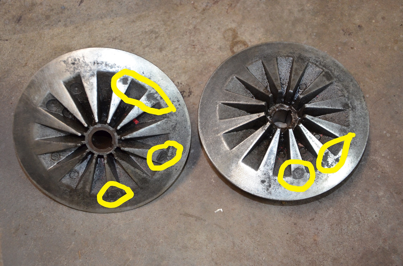

OK. Got the sheaves separated but upon inspection they appear to look pitted inside in some areas. It doesn't look like corrsion but rather bad casting or machining when made. Is this normal and will it affect operation?

This is what the inside of both sheaves look like. Any reccomendations or thoughts on how this would affect operation?
- 1.jpg (643.98 KiB) Viewed 11043 times
Re: control sheaves stuck
I assume that cavitation is fairly shallow, so I think it will have minimal effect on operation.
Thanks. I was hoping for that. They are not very deep. Should I leave them alone or try sanding them out?
