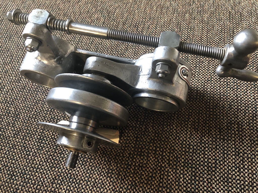

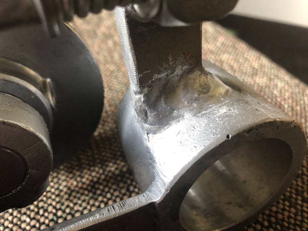

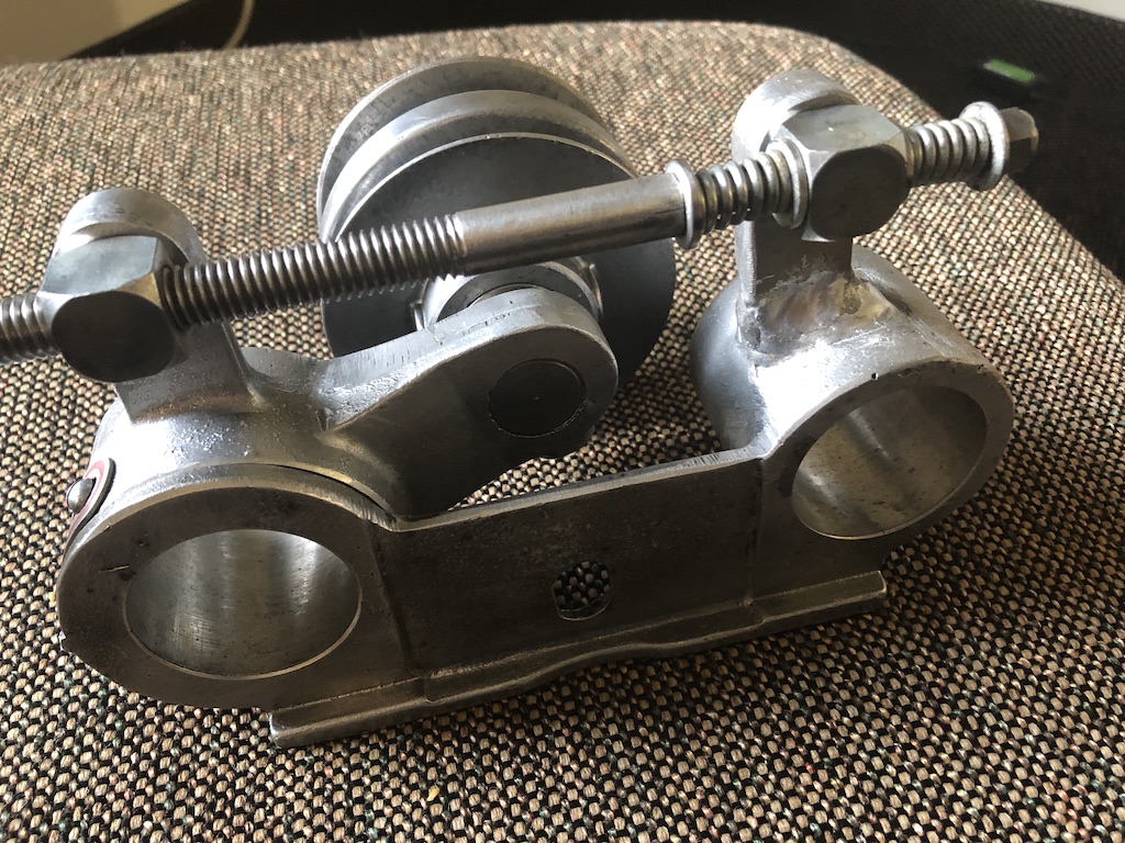

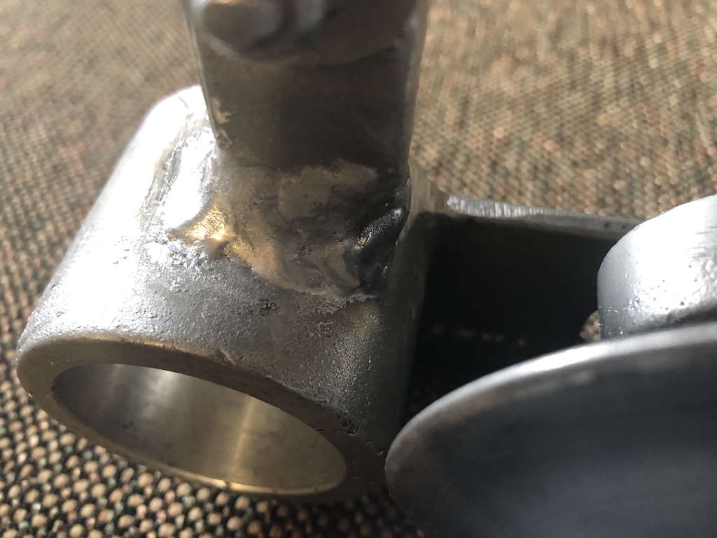

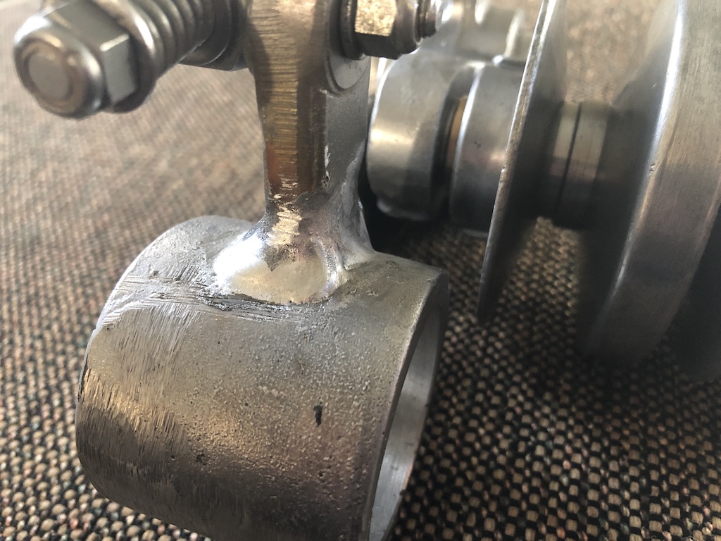

Well here's the update of the update! Picked up the speed changer today from the welder and I'll say I'm very impressed! Kevin (the welder) did a very good job welding the ear back on the SC frame. He also pointed out that the aluminum alloy was a lot different back then as it is today, as Everett pointed out in his last reply on this posting. So here are the pictures of the repair. I'll end up cleaning the weld so it looks better then this before painting. Enjoy!!
Dave V.
Dave V.

Looking good.
If you remount the crank rod on the left (pulley) side of the ears it will move it away from the headstock lock lever so they don't interfere with each other .

I would leave the weld as is. 'Cleaning it up will do nothing to improve it's function and might weaken the 'fix'..
Looks good to me!
Looks good to me!
