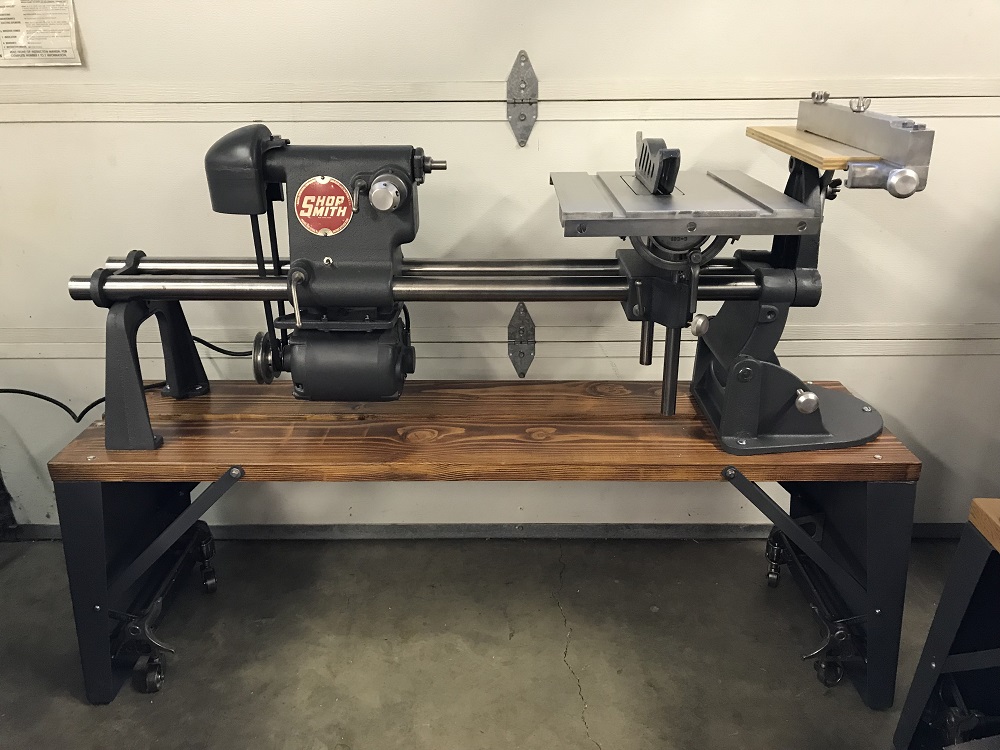

For painting the Model 10's I use Rustoleum Charcoal Gray. It is a gloss finish paint but I prefer to put a Matte Finish Clear Coat over it. The clear coat gives the finish a little extra protection. This makes them very close to the original color and finish. That is the paint finish on 10E S/N 1077 shown below.
1077 on bench r.jpg (222.65 KiB) Viewed 20723 times
I'm glad to here the motor is good. These old motors do seem to last forever or close to it. I have yet to get a bad motor with any of the 22 Model 10's and motors I have purchased. The most they have needed is a good cleaning, new power cord and a few I replaced the bearings. I do replace the power cords since after around 70 years they end up brittle and unsafe. Of course I painted them too. Some I have painted the same gray as the rest of the Shopsmith and others I have painted a Rustoleum Hammered Finish Silver.
