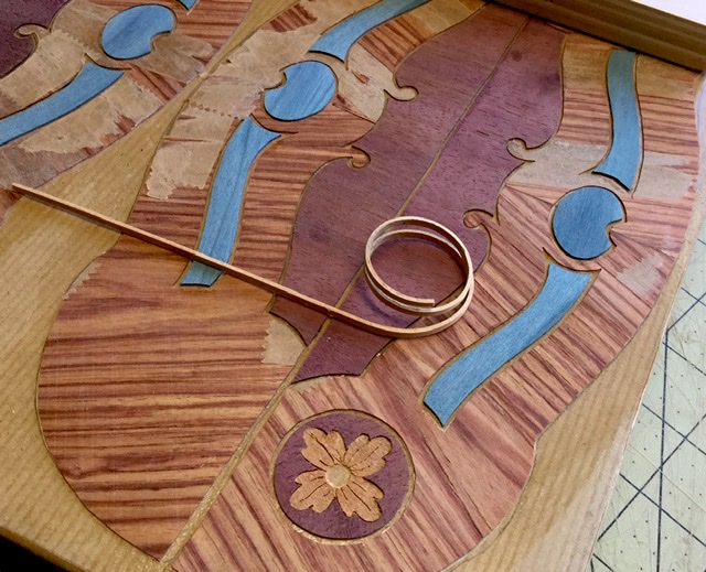

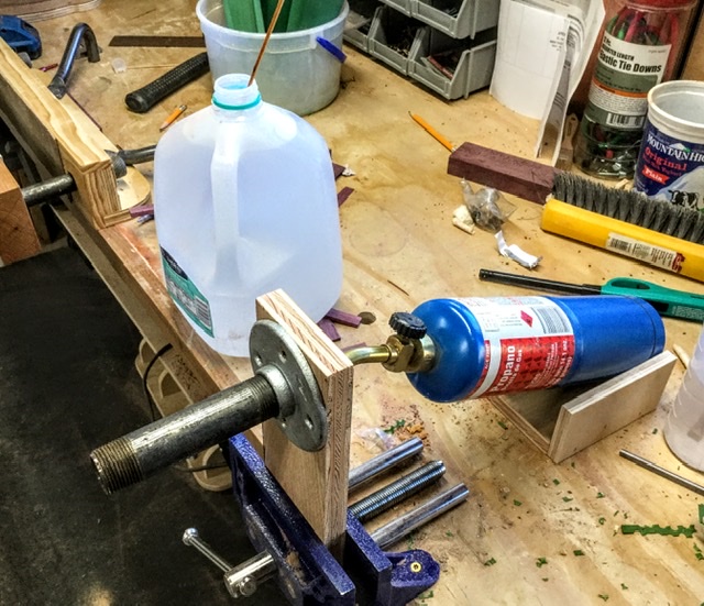

Sorry, I don’t check in often enough but yes I’ve done some hot pipe bending. I use it to shape tight bends in stringing for marquetry pieces. I made up a very simple bender based on google and YouTube searches and it worked great first time.
