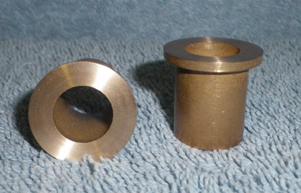

If you have a Speed Changer and are thinking of replacing the Oilite Bearings (shown below) for it, hogwinslow1960 has those also and is the only one I know currently selling new replacements for the Speed Changer. If the flange thickness is worn down it is time to replace them. Also replace if loose on the shaft, shows other wear or is damaged.
Oilite Bearings.jpg (140.21 KiB) Viewed 9097 times
I had one set that I replaced that the flange was almost completely worn away. It's performance was greatly improved by replacing the Oilite Bearings.

Not a bad idea since the Oilite Bearings in the Speed Changer do wear over time. Keeping them clean and "oiled" will reduce the wear and they will last a long, long time. If they are "dry" against the shaft end on the arm and/or the knob that holds it on they will wear faster.

The Magna bushings are not standard. That is why Hogwinslow and Skip Campbell have been buying oversize bushings and machining them to the Magna size.
A problem that the scroll saw arm bushings share.
