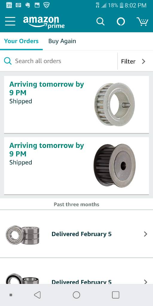

Waiting for pulleys to arrive tomorrow.

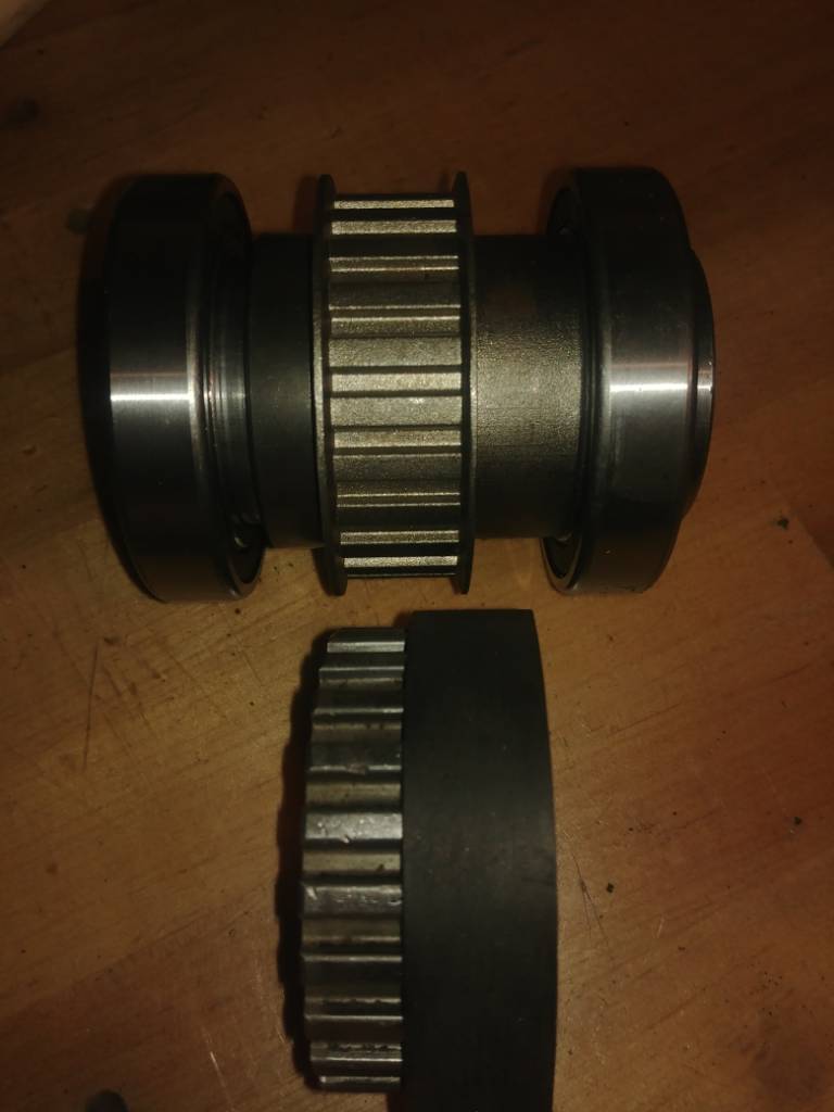

Today I bored one pulley to 50mm and drilled two side holes to secure it onto the spindle shaft.
Sent from my LG-H872 using Tapatalk
CNC4FUN
Posts: 25
Joined: Thu Jan 24, 2019 12:32 pm
Re: DIY DVR motor upgrade / replacement
Post by CNC4FUN »
I will have to cut away side wall on a new pulley because it is impossible to install a belt.
There is no clearance on the top side of the bore and belt can't pass over the right bearing onto the pulley.
Notice a bottom half cutaway on picture but zero on the top of headstock.
Am I missing something here????
Do I see an eccentric sleeve(with the bottom cut out)?
