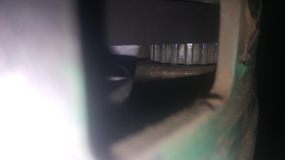

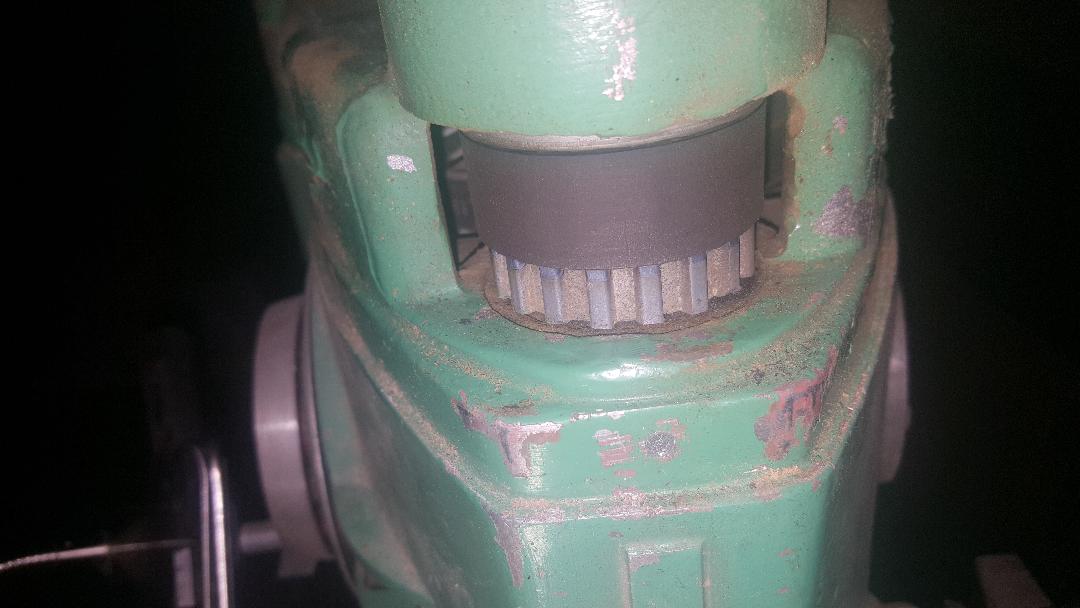

Russ, I have always assumed my April 1955 greenie had the clutch. I took the cover off today and can see the drive but am unsure how to tell if it has a clutch or not. Is there an easy way to determine if it has the clutch, short of a complete tear down? I took photos of what I could see if that could help.
Thanks,
Wiley

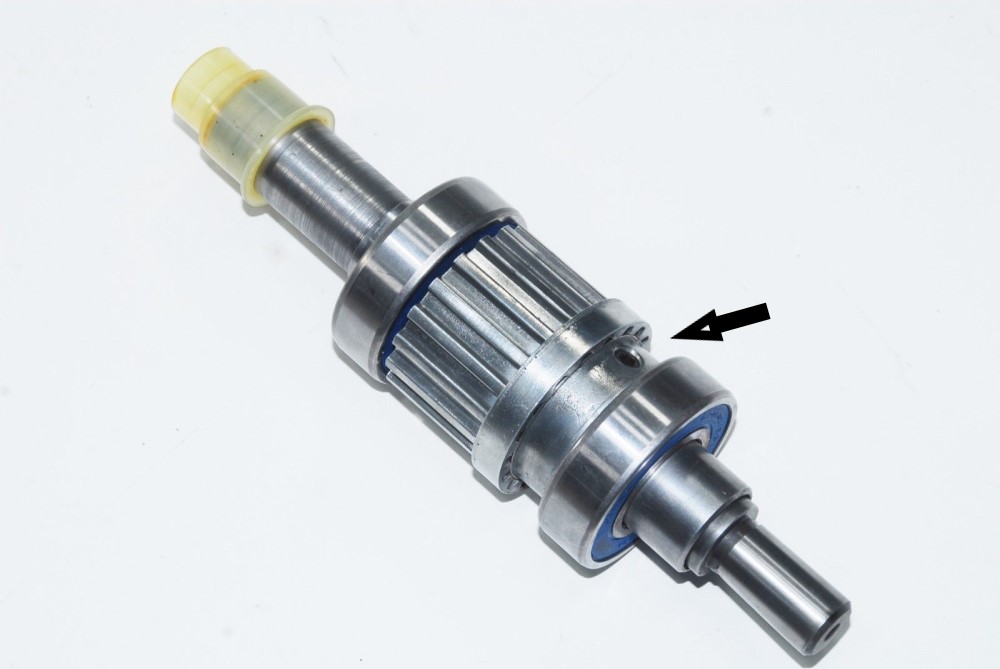

That is the problem with our request. It is harder to tell without having the Drive Sleeve Assembly out of the machine. Look at the end of the gear towards the aux. shaft end.
If you can see on the edge of the Gilmer Gear part, as shown by the arrow in the picture below, the indents there would indicate the clutch. Also the clutched one has the set screw locking collar next to the gear. The collar is the part of the clutch that is locked to the shaft. The collar's diameter is smaller than the gear. The clutched Gilmer Drive Sleeve Assembly has over a dozen parts. Most of the parts you do not want to ever see unless you absolutely have to take apart the assembly to make it work correctly again.
The non-clutched Drive Sleeve does not have a separate collar, just the Gilmer Gear with a set screw that holds it to the shaft between the two bearings. I believe the set screw is in the gear teeth area. There is a retaining ring between the front bearing and gear that is not easy to see without disassembling it. This one has 6 parts.
