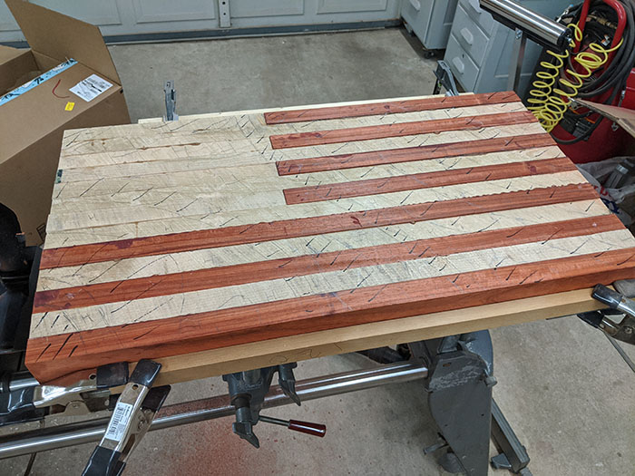

Wonderful! I'm impressed with how realistic the wind-blown flag effect is! cloth blowing in the wind! Did you do the grinding by eye or work from a photo?
Re: Dad's Retirement Gift
Ha - Lots of sanding! I think I spent about 7 hours or so doing it, and I only know that because I was an hour short of finishing the audiobook I had going at the time LOL
And @algale Both. I took a flag photo, and did a rough shadow/highlight map like this... I placed a transparent version of that on my plans, and printed it off. That essentially gave me a map to eyeball the lines onto the flag. If you squint, you can see what I mean: From there it was using the grinder and roughing it to a spot that felt good / deep enough cuts to show some movement. I didn't take any video of the process, but I did take some photos so I might put together an instructable to show it all together.
All in all it was totally doable - the scariest part was the thought of screwing up on expensive wood.

That is outstanding, such creative artwork and a superb tribute to Dad. Top notch craftsmanship and realism. Certainly beyond my skill and abilities.
That said, I can't help but be concerned that given the remarkable quality of that project that others who see it will run out and start trying to replicate it. You mentioned "carved it with an angle grinder chain-saw attachment...". Great respect for you, I am nervous at the sight of such a tool. Have you seen Stumpy Nubs (YouTube creator) incident he had with his carving tool recently? Seriously, not trying to suggest they can't be operated safely, I'm no expert, but please please do be SAFE everyone.
Thank you and Whole heartedly agree!!!Steele510 wrote:t please please do be SAFE everyone.
Going into that particular piece was my most concern, and I jumped over to the flapdisks for rough sanding ASAP. As with almost all wood tools, they are INHERENTLY dangerous - and we can only try and mitigate where possible. I made a few test cuts / runs with it before I made it over to the main piece, trying to get a feel for it.
The risk was never totally mitigated, but all guards were attached, I angled the piece up on the extension table to be closer to my sight lines (maybe 60deg?), and learned through experimentation that the "top right" quadrant was the safest cutting edge to be on. *WHEN* a catch or a gouge happened, that quadrant wanted to pull the machine away from your body rather than towards it, making it easier to plan your safety zone for hands, body, and cable.
All that to say... it has the capability of being a gruesome tool no doubt.
