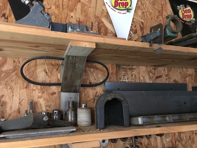

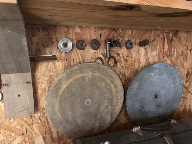

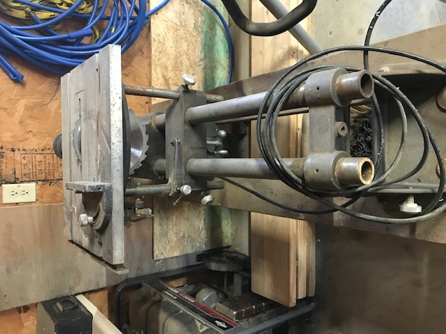

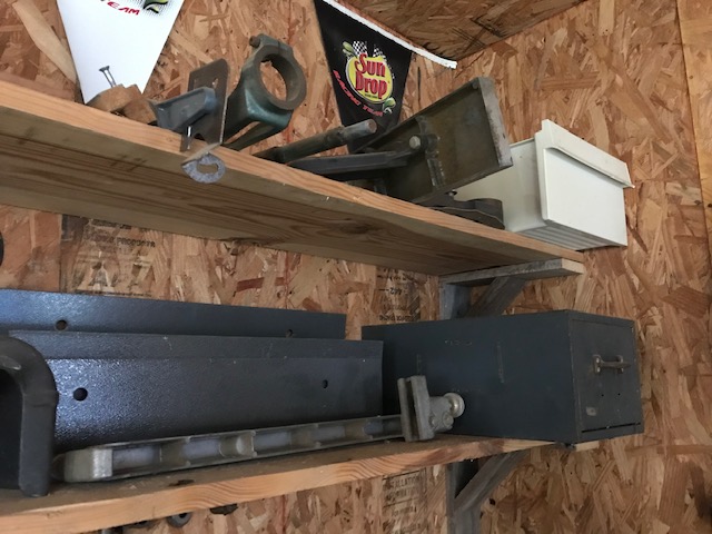

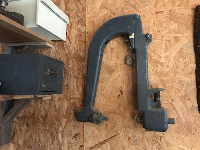

Asking $350. Just don't use it anymore. For its age its in pretty good shape. Have multiple attachment to go with it. 270-804-6451

Looks like a 10ER.
- Posts: 4534
Re: 10E Shopsmith for sale in Western Ky

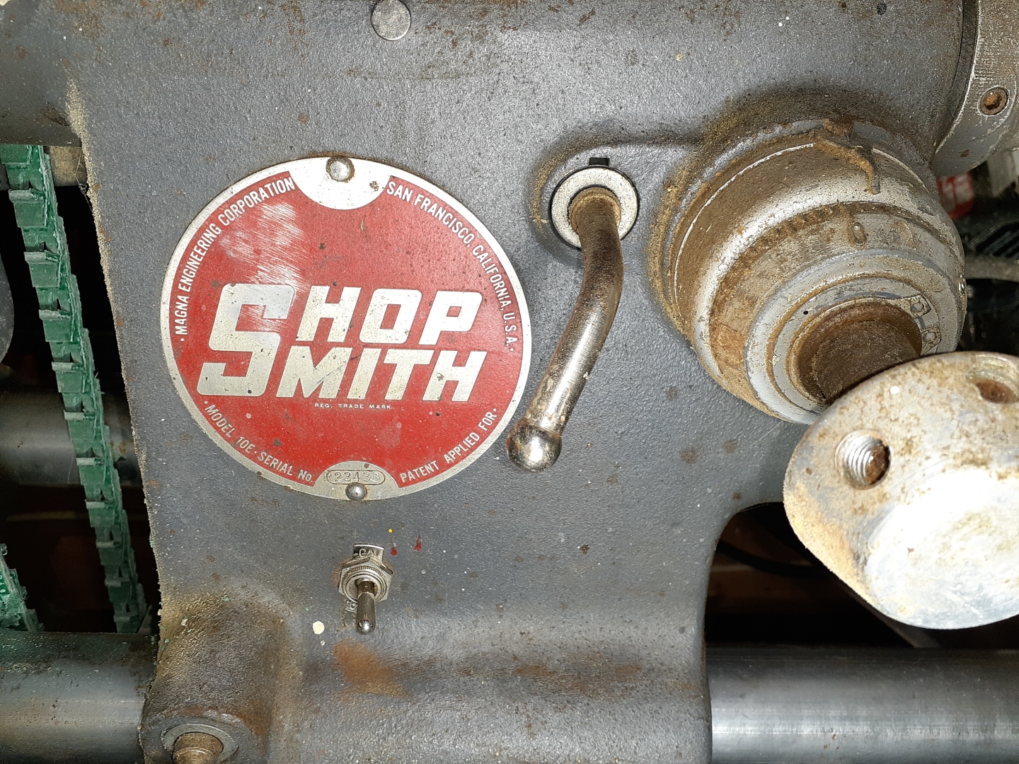

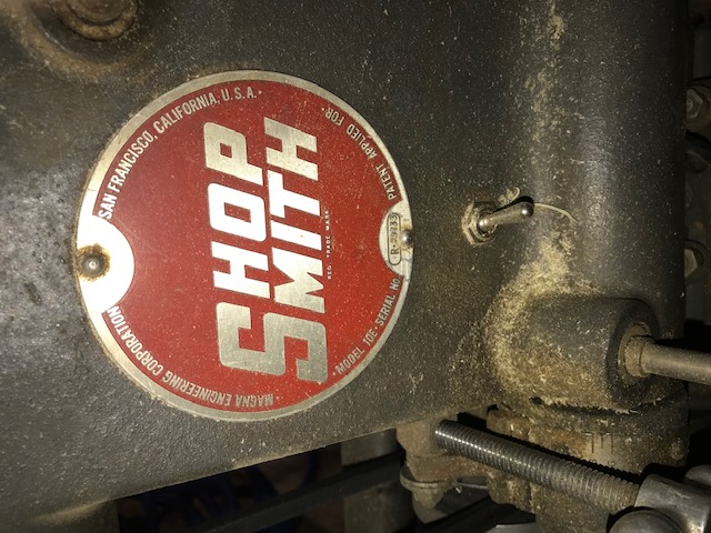

The plate says 10E and if I am seeing it correctly the serial number is R-29733. Model 10E's with the R- prefix went into the 30,000 for serial numbers. It also has early Model 10 parts like the belt cover and the crank for the Table Riser. The extension table on the shelf is the metal one and the fence is the second version for it. The change from wood to metal extension tables had already occurred by that serial number. The Jig Saw is the early version. It looks like the Jointer-Shaper Fence has the wood fence instead of the cast aluminum ones. Being accessories the Jig Saw and Jointer-Shaper Fence could have been purchased anytime, even used. I cannot see enough of the headstock in the pictures to tell which version it is. If I am reading the S/N correctly it is likely version 4. Version 4 is the headstock version being made when the change from the Model 10E to 10ER occurred. Shopsmith's made in the eastern plant have lower serial numbers at the time of the change from 10E to 10ER starting in the 18,000.
- Posts: 35598
ER miter gauge, ER trunion, ER aux table, ER rip fence.

This is my R23430, even though the logo plate still says 10E, it does have the chrome quill spring cover and the other updates that would indicate it is a 10ER.Nov 8, 1947

What is the difference between a Shopsmith Model 10E and a 10ER? For that answer I look at the Logo/Serial Number Plate. If it says 10E it is a 10E. If it says ER or 10ER it is a 10ER. That is how I define them. I won’t go into the discussion of ER vs 10ER here.
