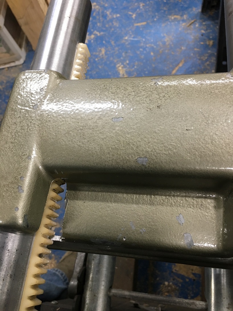

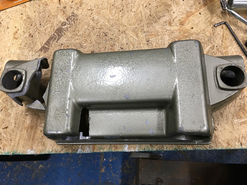

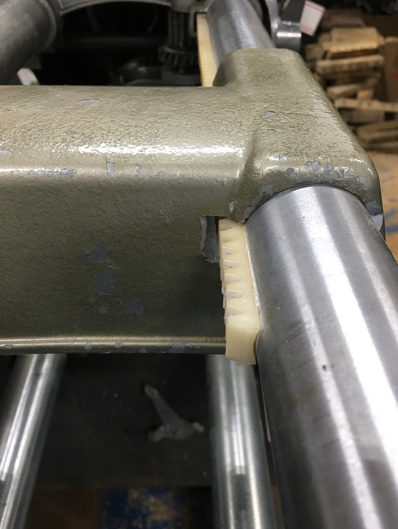

2nd UPDATE- I was able to take a scrap M500 carriage and cut slots to clear the gear rail. (scrap was given to me by a gentleman from Asheville that had a mishap with the lathe. The chisel caught the wood and it drove the chisel into the carriage shattering it. Fortunately he was fine. He stopped by my shop to buy a replacement and a couple other odds n ends.). I cut the slots to mount this cariage to left of headstock so M500 table tilts so headstock is UNDER the table. The one on other end, headstock is above table.
posted couple pics of the test cuts. I have chosen another good M500 carriage (rattie paint) as a volunteer for next victim... errr I meant subject.

You gonna mount shaper/whatever to the fixed drive sleeve shaft?

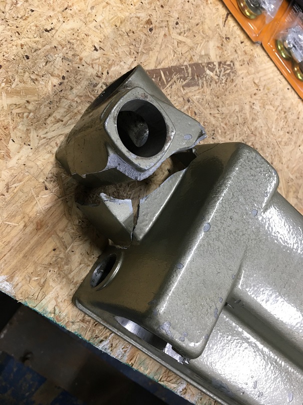

Since I'm seeing pictures of the carriage I'm assuming that is what broke, You wouldn't happen to have pictures of the broken part, it sure would be interesting to see what happened.

As requested- pics of the broken carriage. The chisel hit at front table leg base. It just tweaked his arm but drew it down and not into the spinning work piece. Always a reminder that machines don't care about your appendages.
to answer JPG, the chisel I think was fine other than needed sharpening.

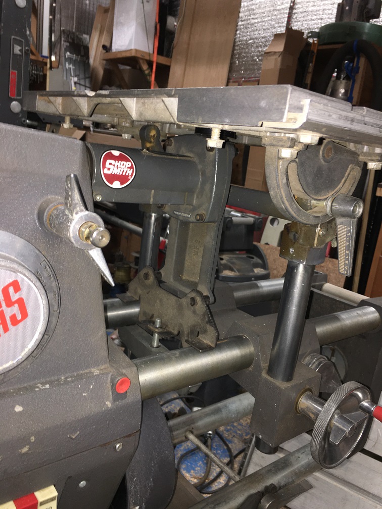

I was also able to mount a speed increaser to the right side of the VII- I had to remove the rod that allows carriage to follow the headstock. I am not sure yet what I plan to use this as but since it lifts both ways and motor goes both ways, it makes it versatile. If it keeps breaking, that is a liability. I have a belt that should be here today or tomorrow and when I am replacing it, will do as many of the bearings as I can- I stock for the V and most look to be the same. The center shaft I believe I read has 2 bearings and a spacer so not sure if I have them or not but Gary does (Bandsaw Warehouse- I have gotten many things from him and he does a great job. I particularly like the blue poly tires he sells. I have rebuild quite a few bandsaws with them including a TotalShop that was crap and I used Shopsmith bandsaw parts to revive it. Only original TotalShop parts are the lower wheel which got new bearings- 2 and a spacer not double-single bearing like Shopsmith saw.

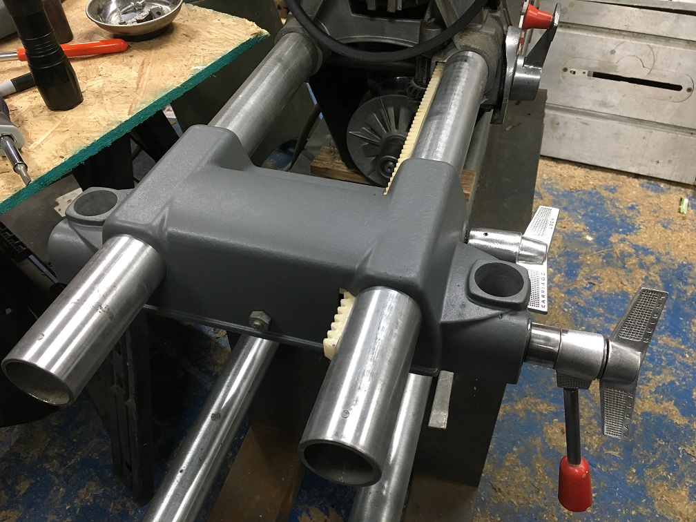

JPG- yes I saw several listings on EBAY for around $45. The one in place is still in good shape so not going to replace it at this time. I did get the replacement motor belt today so will work on that probably over the weekend- depending how a project for the bride progresses. I'll replace as many bearings as I have (should have most) and check into why the impeller rotates on shaft. During work on the bride's project today, , I also dug out a garbage M500 carriage and cleaned it and the parts all up after cutting the slots to clear the gear rail. It was an old greenie that I painted a very close Rustoleum Textured Dark Pewter which is a shade or 2 lighter than most SSmith grays and does have some texture as do the VIIs and early Mark Vs after SSmith was reborn in early 70s. I cleaned up the bores and hardware which were in terrible condition. The lock was almost frozen- front wedge with the right hand threads was sticking and that wedge I had to "persuade" out of the bore by gentle massaging with a dead-blow hammer. I use a wire wheel on a bench grinder to clean the tarnish/grit/dirt/rust/corrosion from most parts. It usually works well.
While I have it apart I'll check other things as well. Friday (tomorrow) I also plan to call the guy that claims to have made cams for people in the past and find out more about these and options and costs for other materials- specifically he mentioned a steel/brass option. The aluminum I am afraid will be too expensive- in the area of $300. I'll update with more info after I talk to him. Time for some head-to-pillow time. :p
