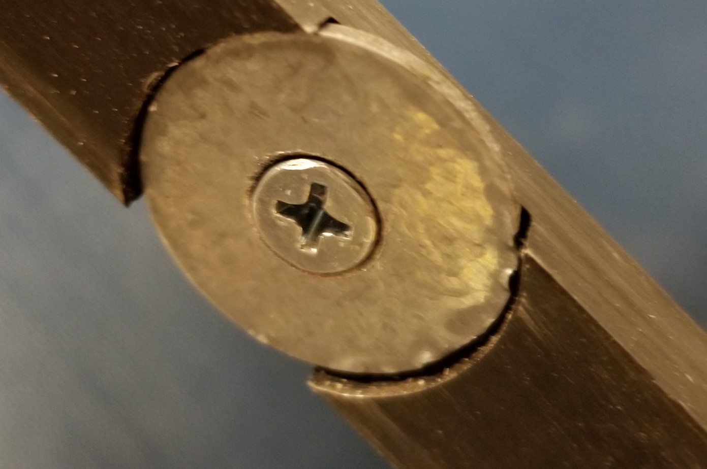

I picked up 3 fender washers 7/8" and 3 screws for $0.17 per pair. Fits slot and does the job. Screw head is below bar, so no countersinking required. Will add thread locker if needed.

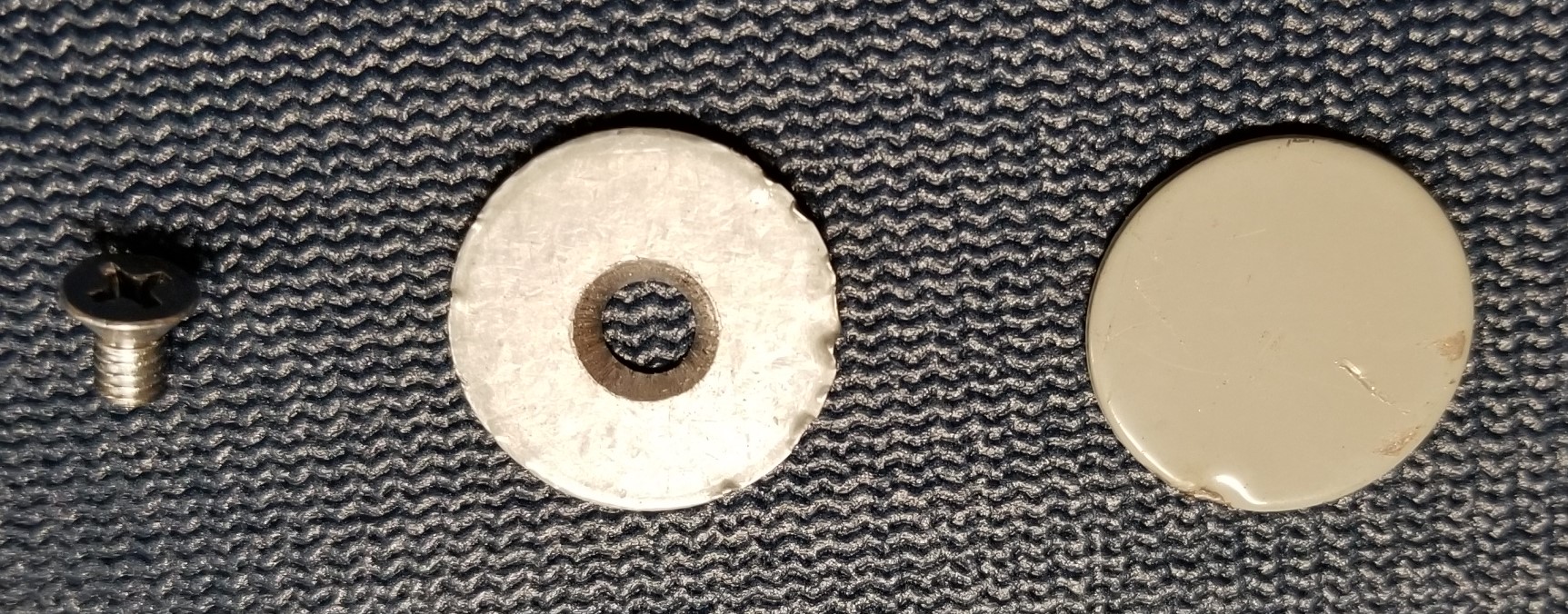

Thank you for this post, I was going crazy trying to find one of these as mine was missing when I bought it. I ended up using the knockout from an electrical box. I put a punch mark in the middle, drilled a pilot hole, and then drilled to the correct size hole for my screw. I used a countersink bit to get the screw head to sit neatly inside the washer.
The fastener was a #8 machine screw, if that helps anyone.
