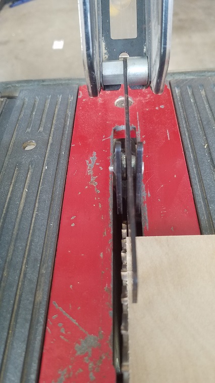

Thanks for the assistance, here is a photo of the alignment problem. This is taken with the guard and arbor fully seated.

The 510 lower saw guard has an adjustment screw to line up the riving knife with the blade. If the screw is missing or threaded all the way in it could cause this issue. The adjustment is a screw located on the lower part of the collar that goes around the quill. The screw is part number 211 on the breakdown drawing of the guard. https://www.shopsmith.com/service/mark/ ... iagram.htm
