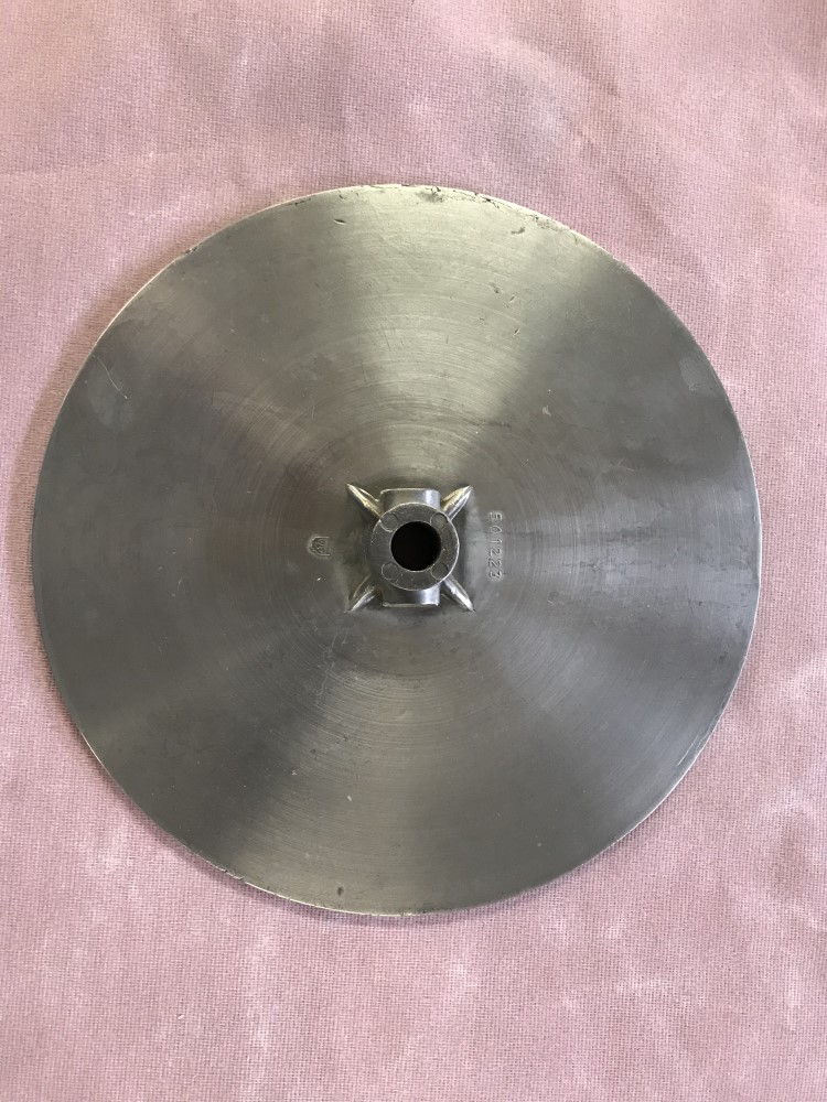

I do have one of the 10" Mark VII Sanding Disks. Below is the only picture I have of it. As JPG said the angle is less than the current 12" Conical Sanding Disk and is hard to perceive that angle looking at it, so even more difficult to see in pictures. As you can see it is a JPG described. The set screw is on the lower side of the hub in this picture and the conical side is up. As with all other items made to attach to the Shopsmith's spindle, with the exception of the 2-1/2" Jointer Cutter Head, it has a single set screw.
I have not used it but it should work the same as the current Conical Sanding Disk. JPG may have used his and may be able to give more input on that. I looked through the Manual but cannot find the angle for the conical side. I mounted it on my Mark 7 (not Mark VII) and it appears to have an angle of 2 degrees.
