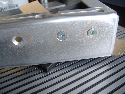

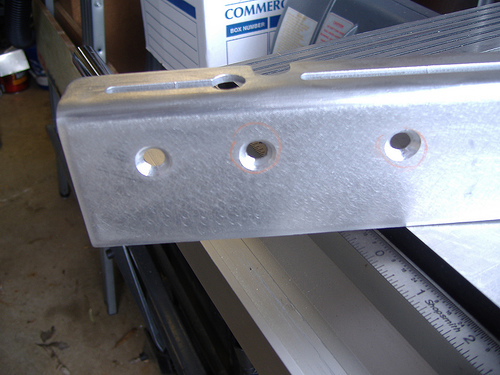

The first problem shown below are the holes that needed work. When the screw heads don't sit flat with the surface and this surface should be flat I don't think it is right... So what happens when you have 6 hole and 5 of them need to be reworked, well you send it back or do it yourself.
[ATTACH]2649[/ATTACH]
[ATTACH]2650[/ATTACH]

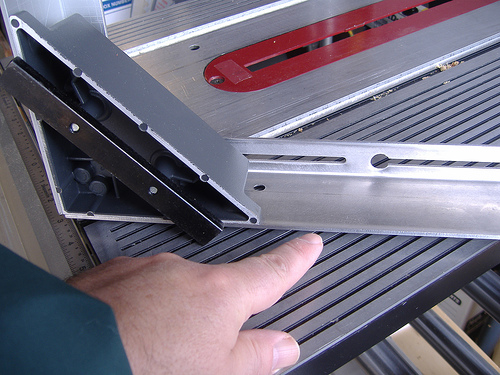

The other issue was with the long arm and the amount of a burr left. It would have made a good cabinet scraper, but that is not what I got it for. The arm with the burr problem and where it would rub over the main table are shown. My finger is pointing to the edge that needed work.
[ATTACH]2651[/ATTACH]
[ATTACH]2652[/ATTACH]

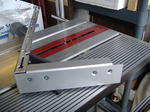

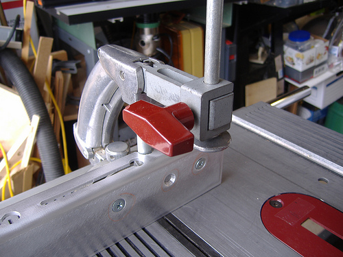

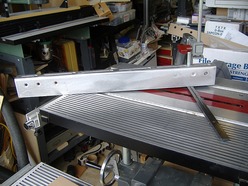

As some of you know the Miter Pro has a short and long arm. They will go on either side of the head. As I said this is common knowledge for owners and those that have studied it but for people interested in the purchasing of one take a look here:
[ATTACH]2653[/ATTACH]
If you notice the arm and the miter gauge and were thinking "hey I bet that those two would fit together" you would be right. And look how nice and long that arm is!!
[ATTACH]2654[/ATTACH]
[ATTACH]2655[/ATTACH]
FYI:
The long arm is also sold as a 24" Aluminum Miter Gauge Extension (555429). You may also know that the 20" Aluminum Extension (556005) will fit the Miter Pro. You can also exchange the arms, short for long, long for shot.

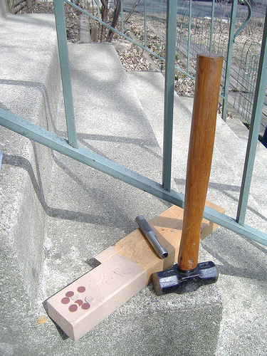

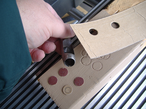

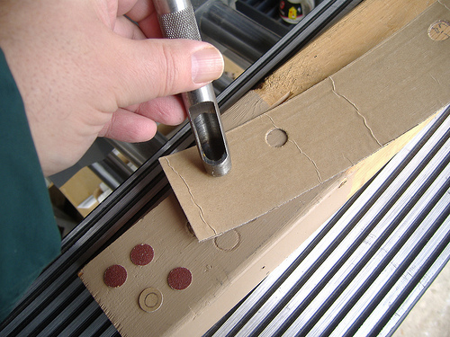

So what is the big hammer for you ask??? Are you going to smash the miter pro in to ball of twisted metal and hang it on the Christmas tree???
No, but I did do some pounding...
When you get to the part where the sandpaper goes on something becomes clear. The sandpaper is going to cover the mounting screws. OK OK I know some of you will put it out in the sun for 15 seconds and have to wear gloves to peal it back etc etc. However here might be another idea for the rest of us folks.
So I think the photos explain this quite well.... and keep in mind the shopsmith is not a work bench so while some the pictures show the shopsmith the hammering was not done on the shopsmith.... Take a look at the first picture to see where the pounding was done.
[ATTACH]2658[/ATTACH]
[ATTACH]2659[/ATTACH]
[ATTACH]2660[/ATTACH]
[ATTACH]2661[/ATTACH]

Just before I put the sandpaper on the long arm some at the other site had a problem so I was looking at mine again and guess what??? It was perfect, not. With a straight edge against the arm was all but straight.
If you can call 1/8" gap at 22-1/2 inches out on the long leg a "little problem". I had a "little problem".
The error didn't take long to spot, about 6" down from the intersection the long arm started to bend back and guess what, the error just happens to add up to the gap I'm seeing.
I gave it a "treatment" and got it down to about half the amount. Additional efforts got the amount down to almost straight but you still can see light down at the end. I didn't want to go to far so that is where it stands today.
It seems to me that part was a trouble maker from the get go. If you buy one of these that is where I would start checking it over. I will say this tool and I have not been friends yet but life is not over so who knows??
