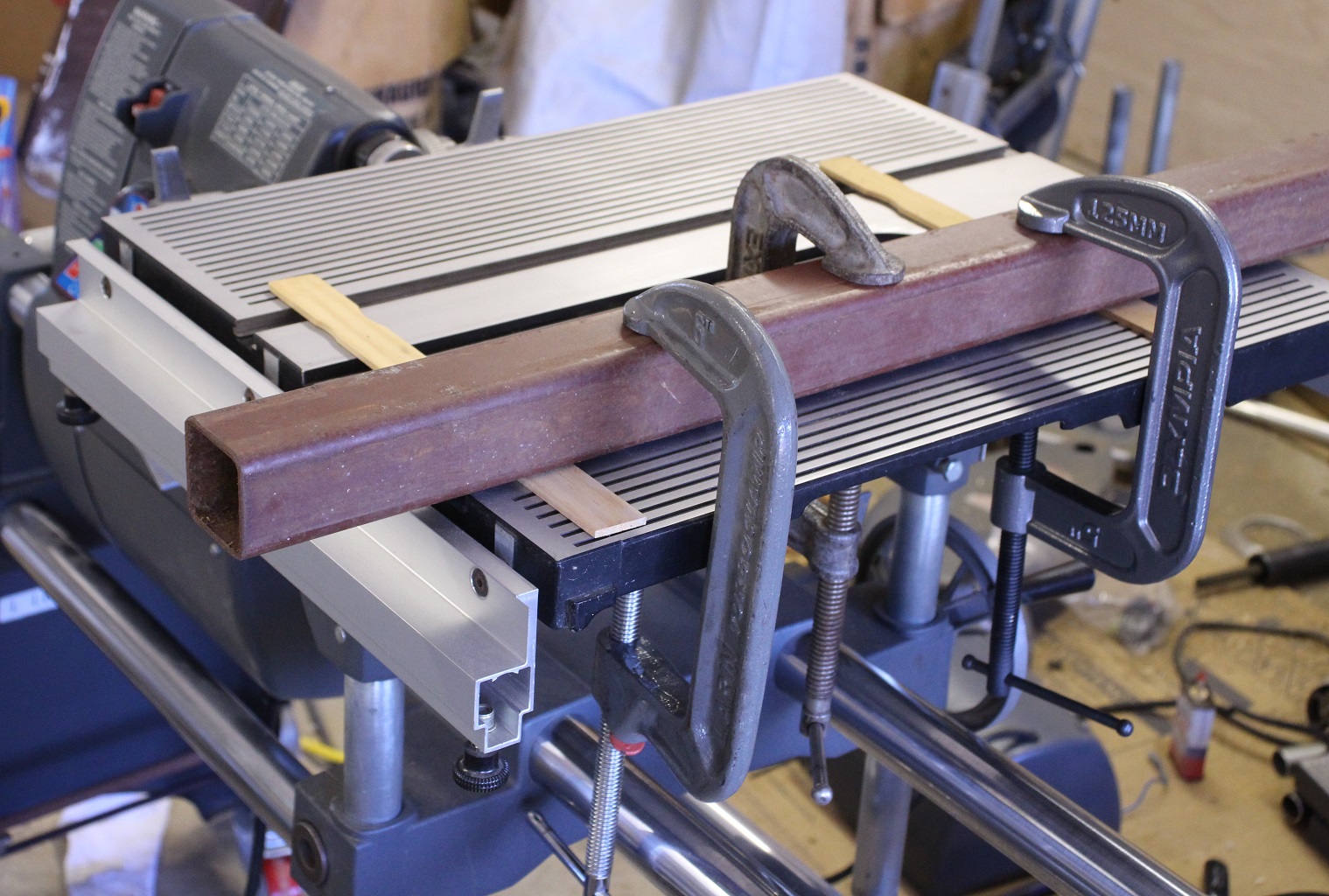

Okay, here is the reconstruction of the method I used. On mine I reduced the magnitude of the low from something over .060 to something under .003. These pictures are with the table mounted, when I did it I removed the table and did this on the bench. And yes, I know my table is mounted backwards in these photos, left just means as normally mounted, the side closest to the headstock. The left side of the table, starting from the insert, is considerable less robust than the right side. The strongest part seems to be the T-Slot, so I focused on straightening the T-Slot and let everything else follow on its own:
Table Flattening Setup
I used a scrap of heavy walled (~.120) 2" square steel tubing. It is directly over the T-slot and the bottoms of the clamps are on the T-slot part of the casting. This tube will flex under the load but not as much as the table. Stiffer would be better, but this was adequate. I used steel shims but they can mar the surface, so if I did it again I would use something else. Paint stirring sticks are illustrative only. Thin shims help to keep you from bending the table too much at one time.
Measure your table flaw left to right as well as front to back. Position shims and clamps so that your force is applied where it is needed. On mine, measuring left to right, the table was flat for about the front three inches, so I put my front shim where the defect started. I think I used five C-Clamps when I did this, three is illustrative.

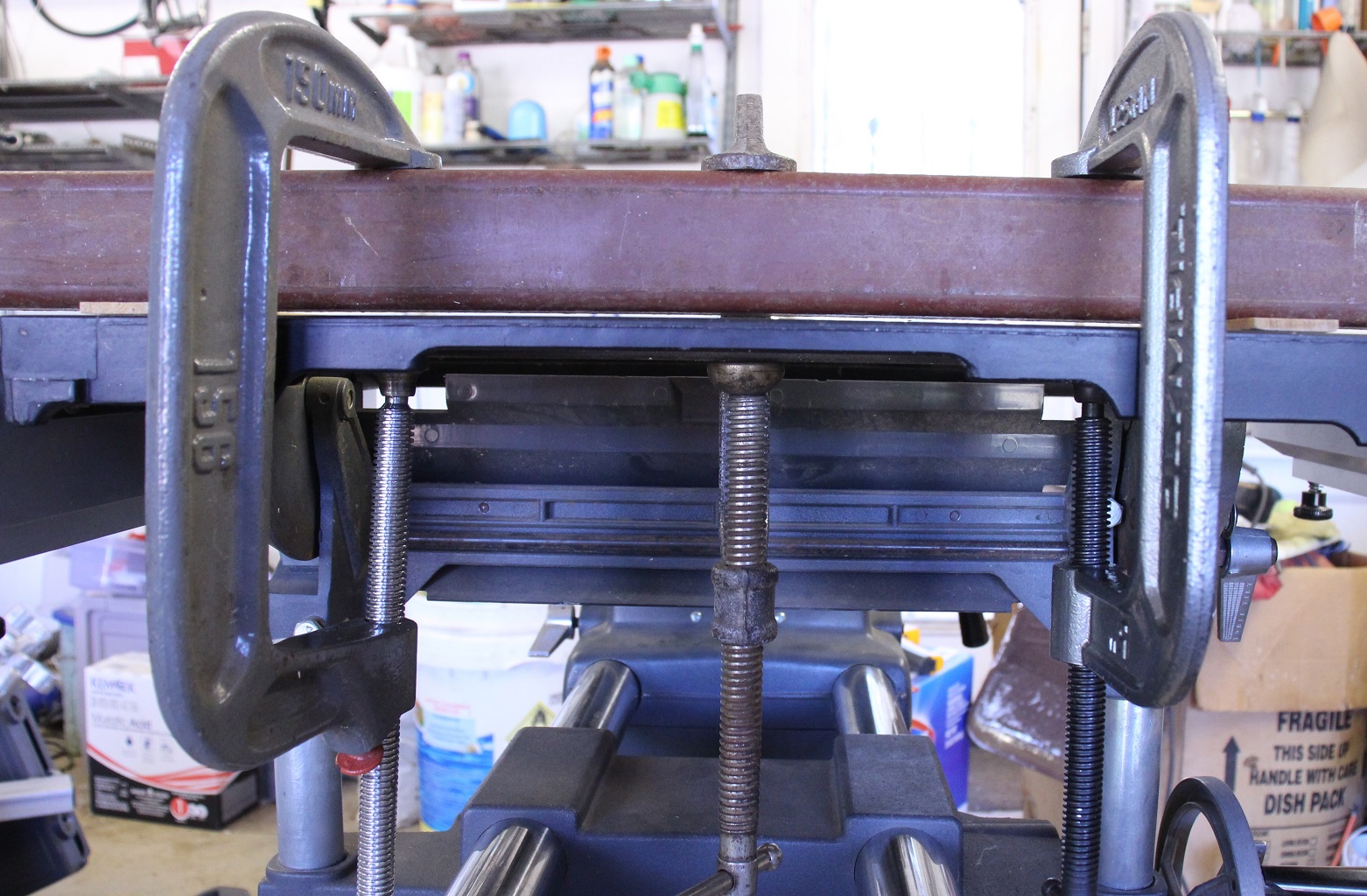

Gap with clamps
Gap with clamps
When you start tightening the clamps the table will flatten and then bow up slightly into this gap. Tighten the clamps a little at a time and keep re-tightening all clamps to distribute the pressure. I let mine sit for a while under clamping pressure. I did this over several iterations, relieving the pressure and measuring in between. Sometimes there was no improvement, indicating not enough pressure. My first attempt was without the shims, the table flattened under clamping pressure then went right back where it was when I removed the clamps. For the most part it is a learning process, you'll get a feel for the relationship between pressure applied and result achieved. You don't want to go too far.
This is a brute force method. If we find that there is more elegant solution (the Nick $20 solution) I'd use that instead. My going in position was 'this table is scrap, I can't make it worse.' When you install the table loosen the tilt lock a bit so you pull the trunnions to the table rather than vice versa. And since you have messed up your alignment this would be a good time to think about shimming the front or back trunnion/table junction so the table is perpendicular to the spindle in that direction. This method worked for me and I hope it works for others. It is not without risk of permanent damage.
- David

DLB wrote:Okay, here is the reconstruction of the method I used. On mine I reduced the magnitude of the low from something over .060 to something under .003. These pictures are with the table mounted, when I did it I removed the table and did this on the bench. And yes, I know my table is mounted backwards in these photos, left just means as normally mounted, the side closest to the headstock. The left side of the table, starting from the insert, is considerable less robust than the right side. The strongest part seems to be the T-Slot, so I focused on straightening the T-Slot and let everything else follow on its own:$matches[2]
Measure your table flaw left to right as well as front to back. Position shims and clamps so that your force is applied where it is needed. On mine, measuring left to right, the table was flat for about the front three inches, so I put my front shim where the defect started. I think I used five C-Clamps when I did this, three is illustrative.IMG_8556.jpg
- David
Thanks David, that makes a lot of sense. I’ve used the same basic technique many times to straighten sheet-metal parts, but it never occurred to me that it could work on a SS table as well.
Like Dusty, the dip in the center of my table is mostly an issue for small parts. I tend to notice it when trying to rip a true 90 degree edge on small workpieces. I could probably improve it with your straightening technique. But then again, making a small-parts sled might be an even better solution for me, because that generally takes table-insert flushness out of the equation as well.
