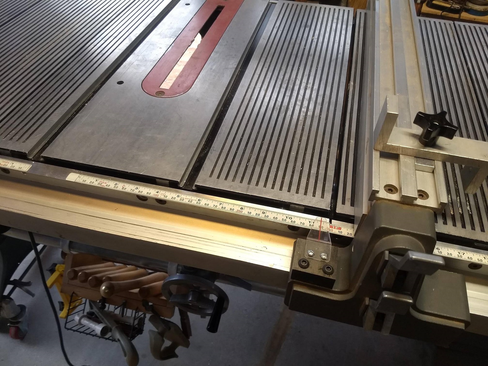

Somewhat related, I saw on the FB group a while back where someone didn't want to pay Shopsmith for the price of the replacement stainless steel tape measure for their 520, so they added on some angle aluminum to the 520 rails to give a flat platform where they could mount their own permanent tape measure in place of the magnetic one. I can't dedicate my 520 to saw mode only like in the picture below, but this idea does look interesting.

RF GUY ....
This is a photo of my Shopsmith and my SS rip scale system. Welcome to use it of course - I am only adding this to correct the writer's error... my saw is not dedicated to saw mode only. You are assuming that is a single ruler when in fact it is cut at the edge of every table. It all slides together well enough that it actually looks like a single piece...
It works very well. I simply have to reassemble the accessory tables in the right order when I want to do accurate sawing on large pieces, as each extra table has a ruler that butts up to the previous ruler in only one order....
95 percent of the time I'm just using the main table where that is not an issue.
Geoff Baker
Thanks Geoff. Boy, it sure looks like one solid piece, so I am surprised to hear you say it is sectionable. If you get a chance, could you post some more pics of it? How does the ruler hold up on those in between sections, i.e. at the cuts? Your setup is one of the best looking setups that I have seen for this. I finally gave up on using the stainless steel rulers that came with my 520 setup. It is just too easy to bump them and through off their alignment. Where did you get your rulers?

jsburger wrote: Do you see a picture in Geoff's post? I sure don't see it here. :confused:
Only pic so far is the one that I posted back on March 16th, but this was a picture he (Geoffrey) posted on Facebook. I couldn't remember the source when I posted back in March until he posted today on this thread...

I think he is referring to the picture in RFGuy's post above, evidently taken from a post elsewhere:
https://www.shopsmith.com/ss_forum/view ... 27#p258027
This looks like a good approach to me, but I found when I used the SS version of the scale I was spending too much time zeroing the blade to the measurement or vice versa. It just doesn't work with how I use a Shopsmith. I routinely use the quill feed to make small adjustments to rip width, taking the blade out of 'zero' almost every time I change.
