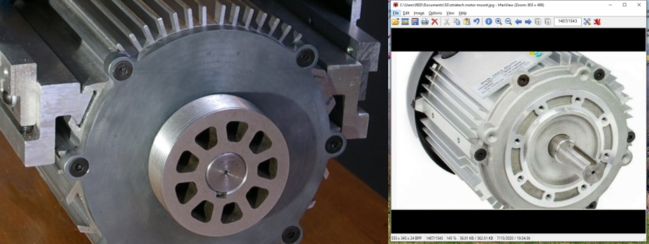

Regardless of who designed the electronics, the Shopsmith design had severe physical limitations placed upon it to get it all inside the headstock(which had heat buildup problems with the reeves drive to begin with). I find it interesting that the Striatech product appears to be much smaller in an external package.

Re: Powerpro problem-maybe?
"Due Diligence"?
pp vs stritech mouint.jpg (192.68 KiB) Viewed 6837 times
