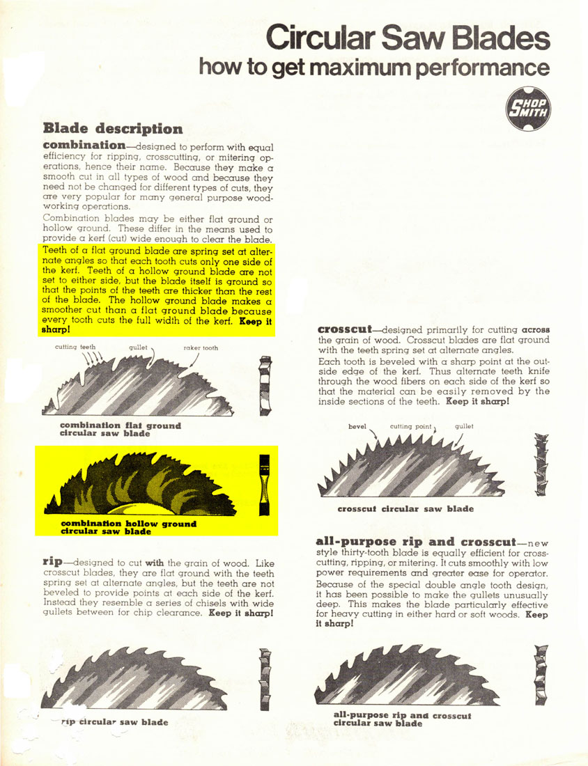

The combination steel blade pictured above is a hollow ground combination blade. As the attached description states, it is not recommended for general sizing cuts or general purpose use. I have one and found it OK for specific cuts, but it does have limited use. I seldom use it anymore since I got my carbide tooth blade.
The 60 tooth carbide tipped Craftsman blade should be a fine blade for learning ... perhaps a little finer cut with more teeth than necessary, but you have it and it should work fine.

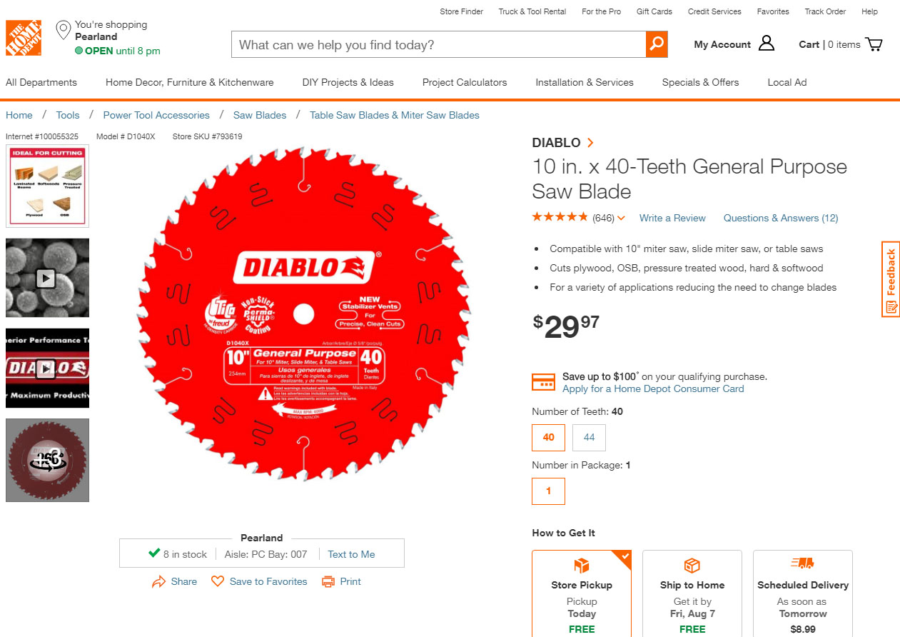

My general purpose blade is Diablo 40 tooth carbide from HD.
blades 2.jpg (513.71 KiB) Viewed 3007 times
Diablo 40 tooth general purpose.jpg (209.59 KiB) Viewed 3007 times
