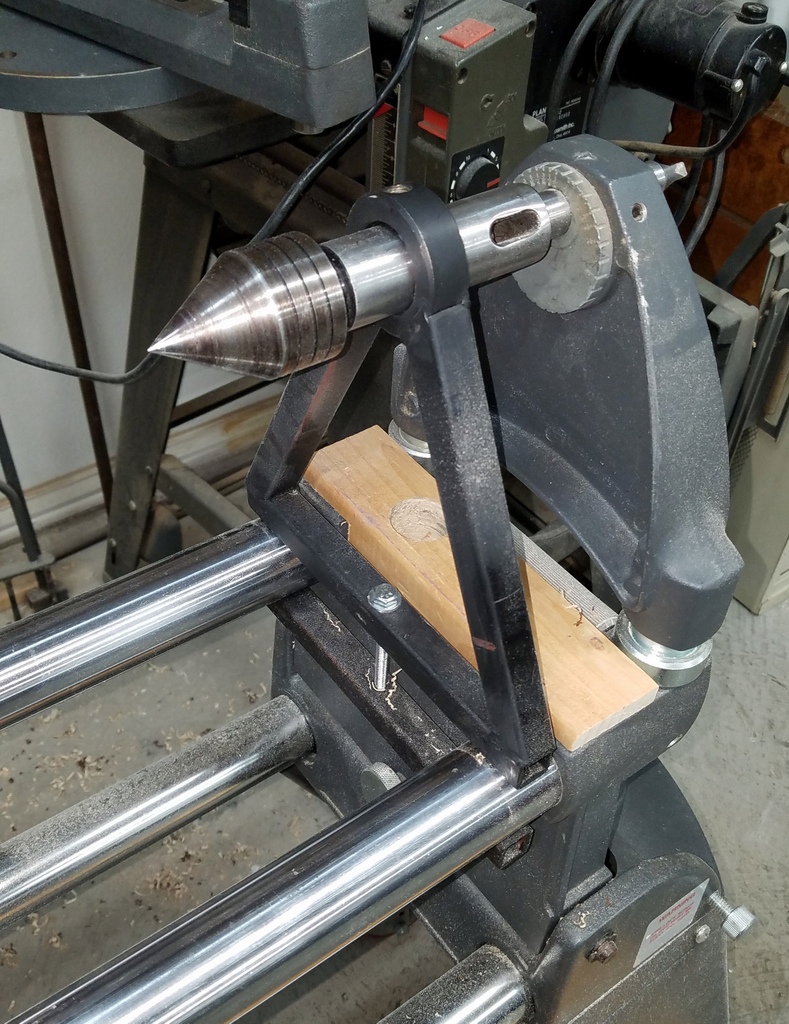

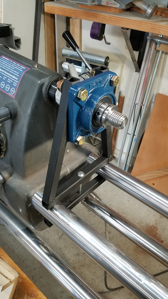

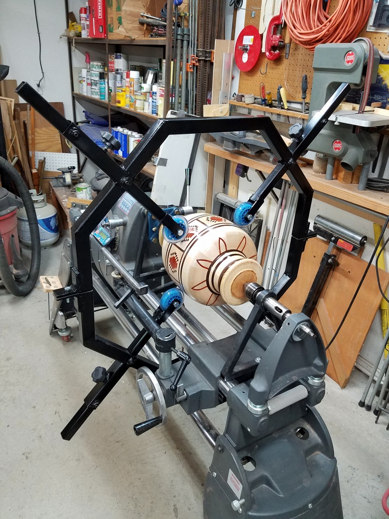

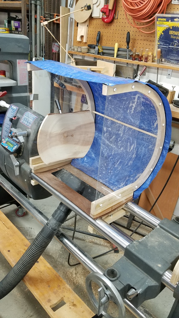

Over the years I've made a lot of different jigs / add-ons for my Shopsmith. I'll see if I can list a few of the better ones.
Tail stock brace that's adjustable, left, right and back and forth.
After bending the quill shaft twice I built a way to convert the 5/8" shaft to 1" for turning large items.
Extending the live center and giving the tail stock support more support for large turnings.
Extending the live center past the end of the base to turn long pieces.

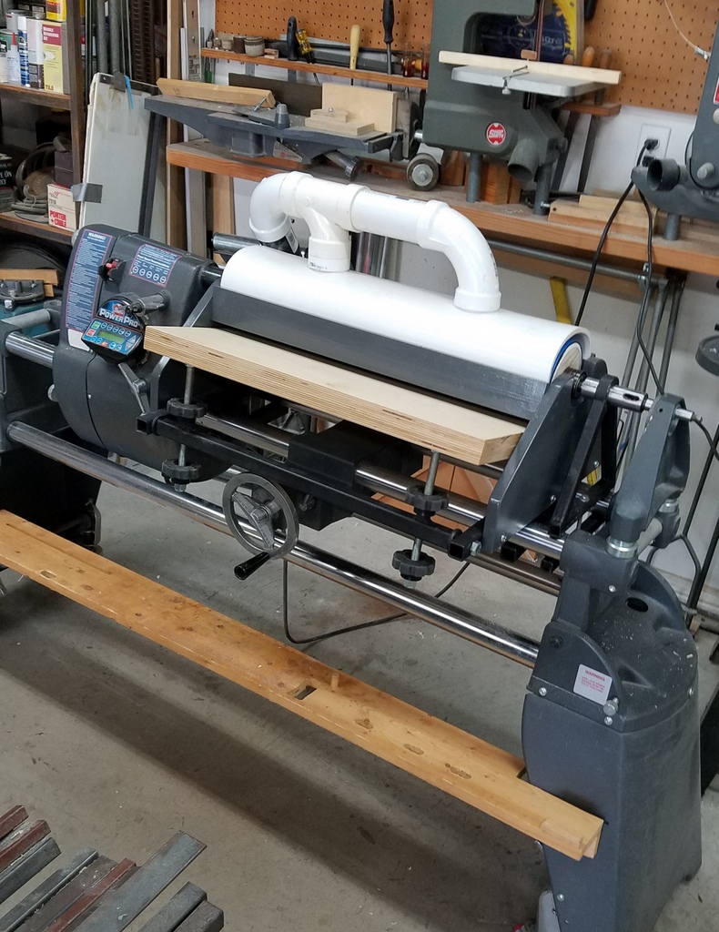

Drum sander, I saw on youtube.

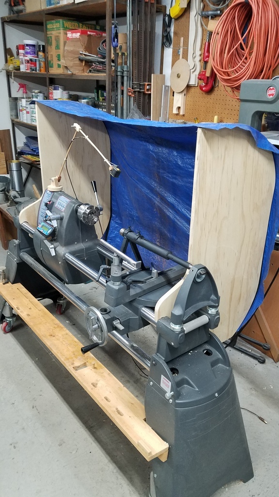

Sanding hood for sanding bowls
Lathe shield for flying chips

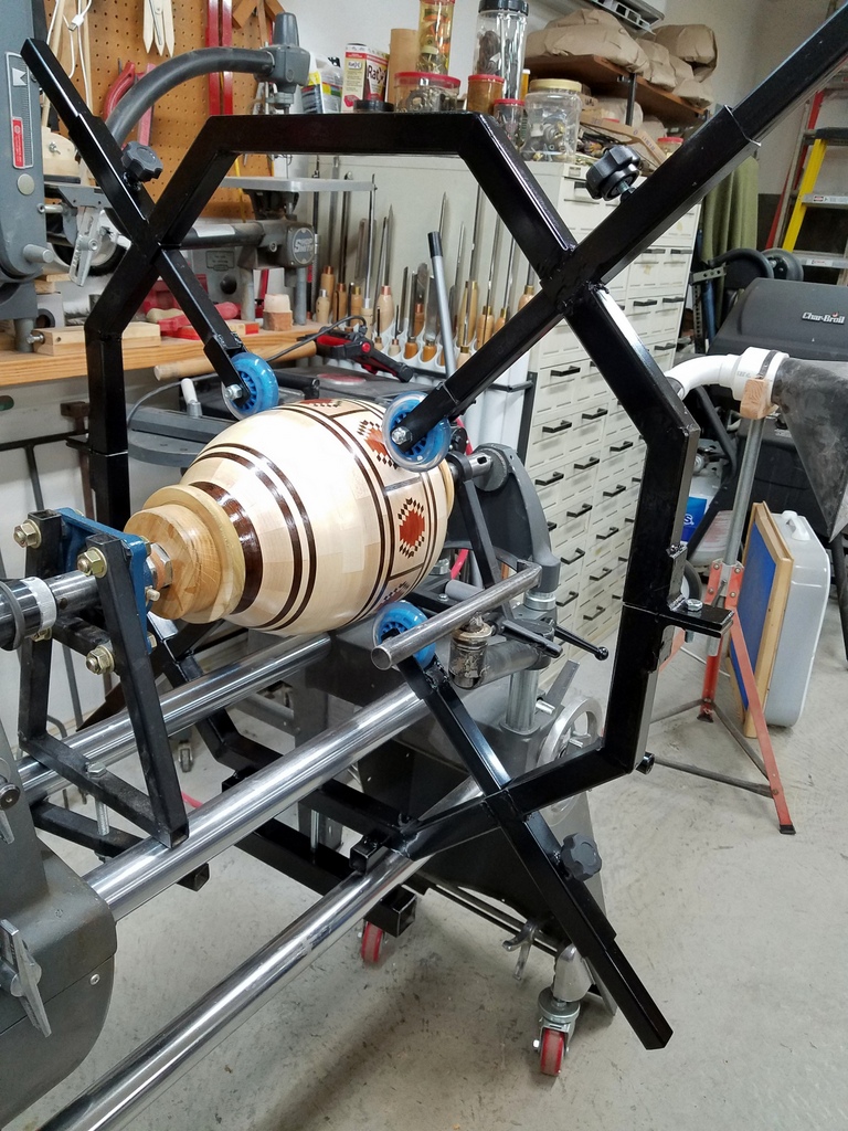

Steady rest for the lathe
- drumsander.jpg (341.66 KiB) Viewed 15042 times
- lathe chip shield.jpg (280.75 KiB) Viewed 15042 times
- quill conversion.jpg (273.93 KiB) Viewed 15042 times
- sanding dust collector.jpg (330.76 KiB) Viewed 15042 times
- steadyrest1.jpg (383.24 KiB) Viewed 15042 times
- steadyrest2.jpg (400.65 KiB) Viewed 15042 times
- steadyrest3.jpg (196.53 KiB) Viewed 15042 times
- tailstock extender.jpg (492.9 KiB) Viewed 15042 times
- tailstock extension1.jpg (341.8 KiB) Viewed 15042 times
- tailstock extension2.jpg (368.56 KiB) Viewed 15042 times

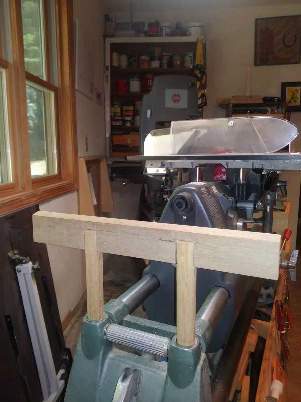

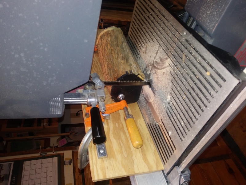

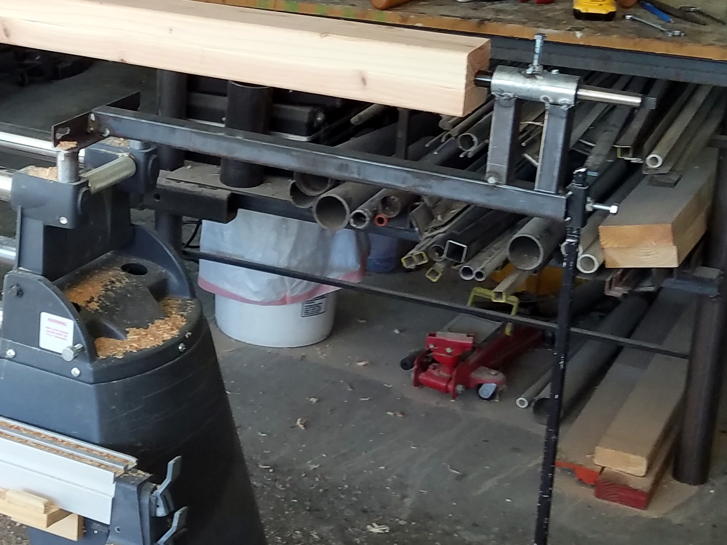

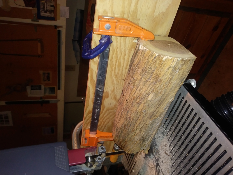

The idea I have to share for a Shopsmith "hack" is much simpler, but it did work well for me.
A while back I was given some large (4-6 inches diameter) pieces of lilac. I decided that I would make most of it into turning blanks, but wanted to make small boards out of some of the clear sections. On line and in the magazines I have seen lots of clever and complex devices to hold small logs on the bandsaw for milling, but I wanted something simple, fast, inexpensive and that could be made with materials I had on hand. What I came up with is a tall fence and some clamps. Works great...it easily accommodates different lengths and diameters, is easy to make and easy to use.
Those are some very creative mods to the lathe.

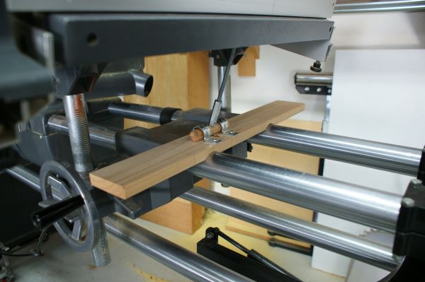

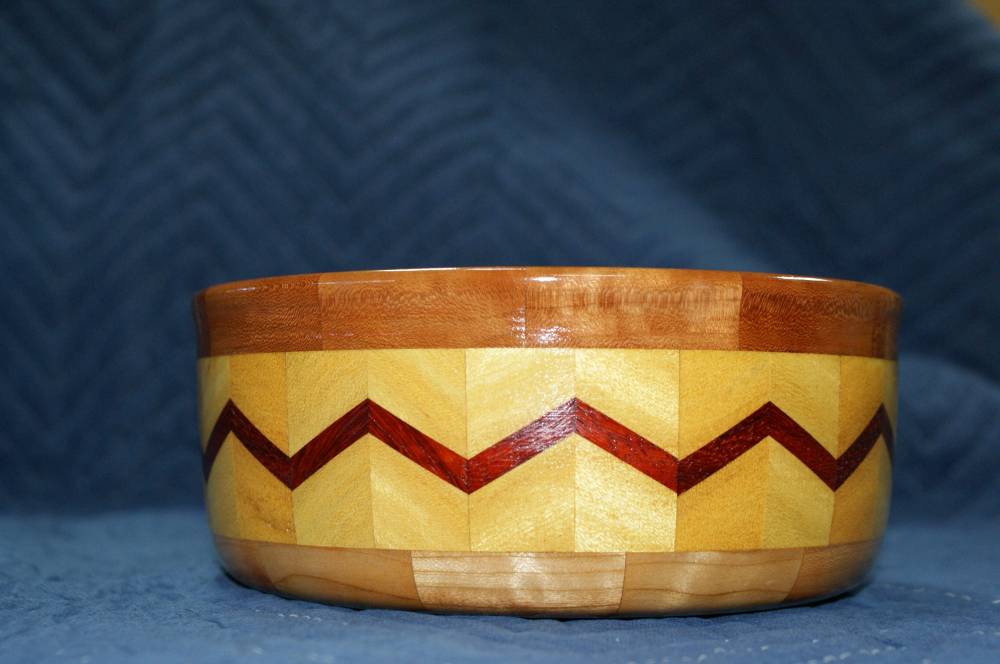

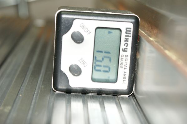

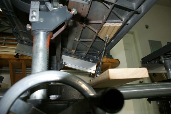

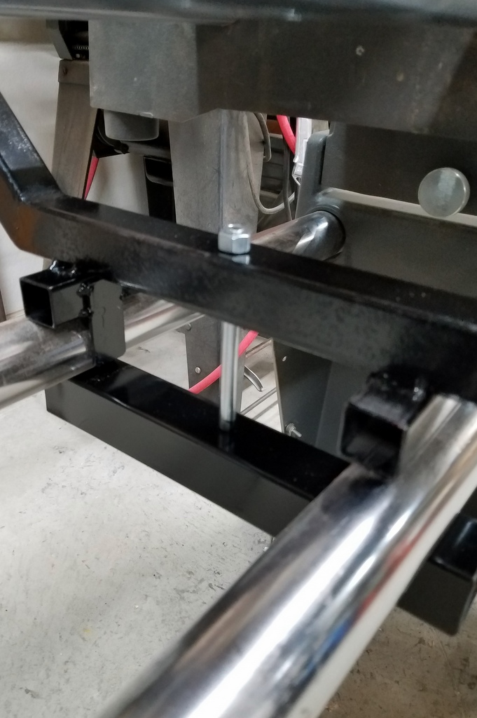

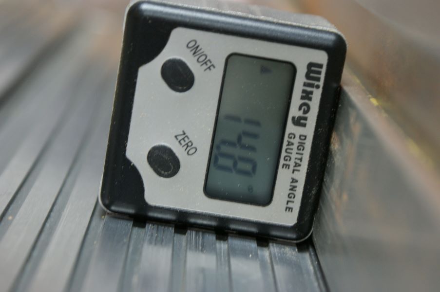

I have a little something that I would like to add to this discussion. I call it the "Tweaker". I like to do segmented turning but sometimes the normal jigs o not work out as when in a feature ring and the pieces have to be cut with the piece in the vertical position.
I started by placing a piece of wood in the webbing under the main table. The piece has a "T" nut inserted on the table side. The hole in the block is for a 1/4 20 threaded rod.
The rest of the system consists of a support block made to ride on the way tubes. This support holds a 3/4" dowel with an elongated 1/2" hole drilled through and captivated by two 3/4" conduit clamps. The threaded rod from the under table block has a 1/4- 20 connector bolt threaded onto it and extends from the table through the rotating dowel in the lower support.
To install the system raise the table and move it to the right end of the machine and insert the 1/4 20 rod from the table through the dowel and through the base and lower the table until the base block rests on the way tubes and lock the table height lock. Then loosen the table tilt lock and and tilt the table to the approximate tilt angle. When the connector bolt is in contact with the dowel and the table tilt lock loose the table can be raised and lowered to adjust the tilt and then adjusted to the final angle that is desired. I put the fence on the table to add a bit of weight to take out any play and to have a place to put the Wixie. It will take about 3/4 of a turn of the connector bolt to change the angle by about .1 degree.
I used this gimmick to do my Christmas bowl completely on the Shopsmith Hope someone can use this.
Bill V
Bill V
