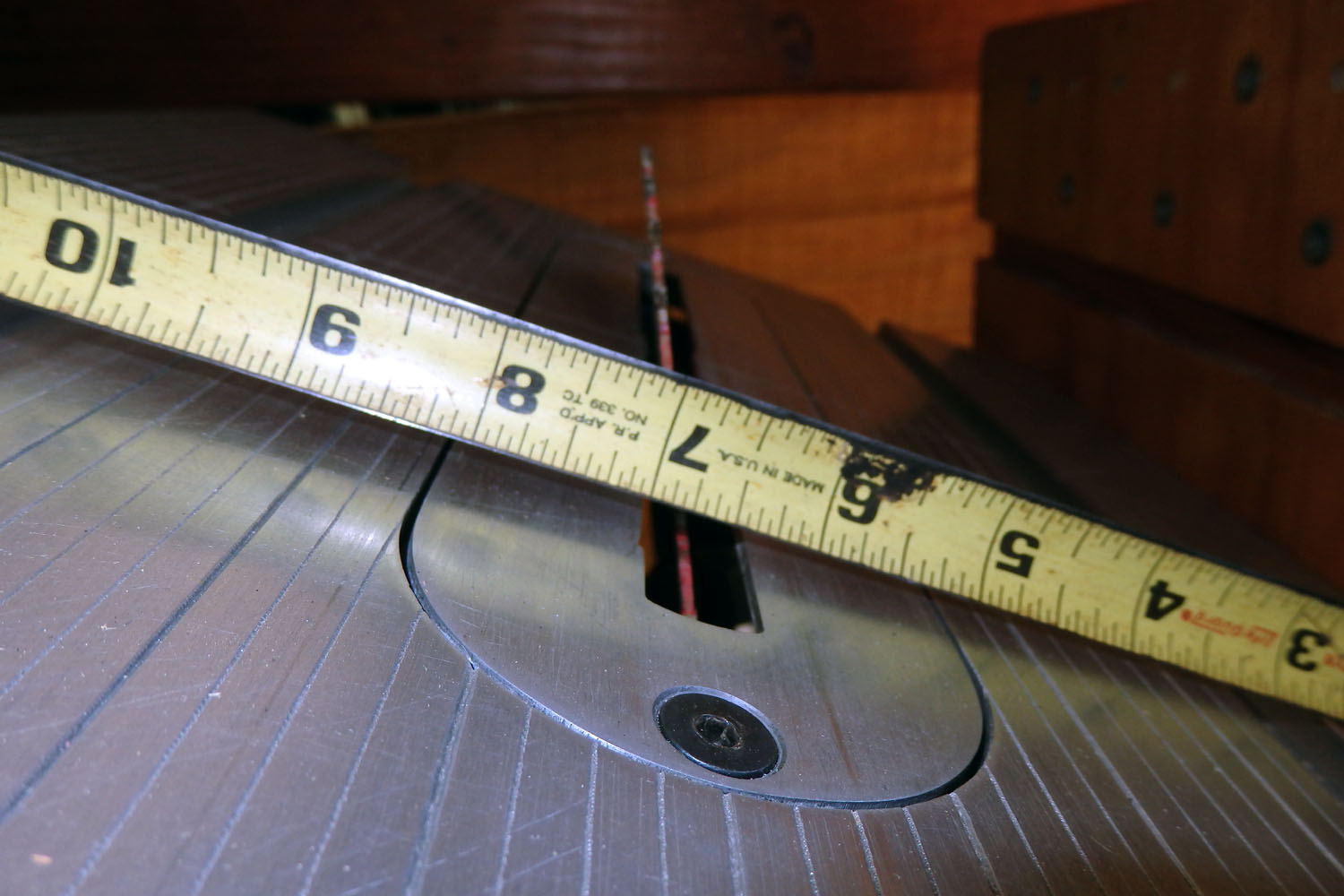

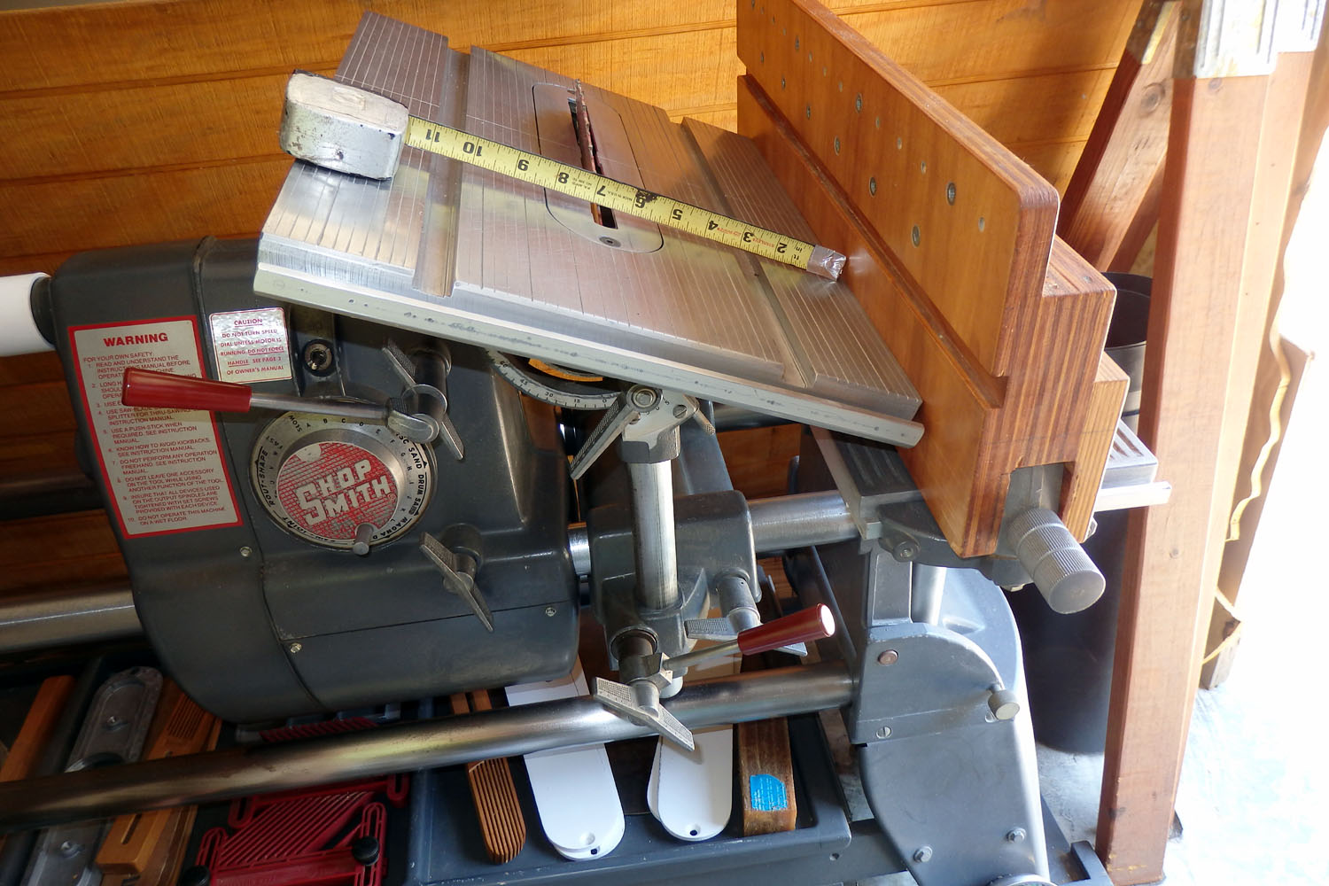

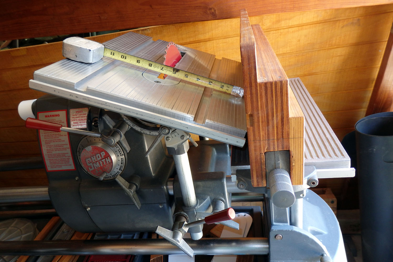

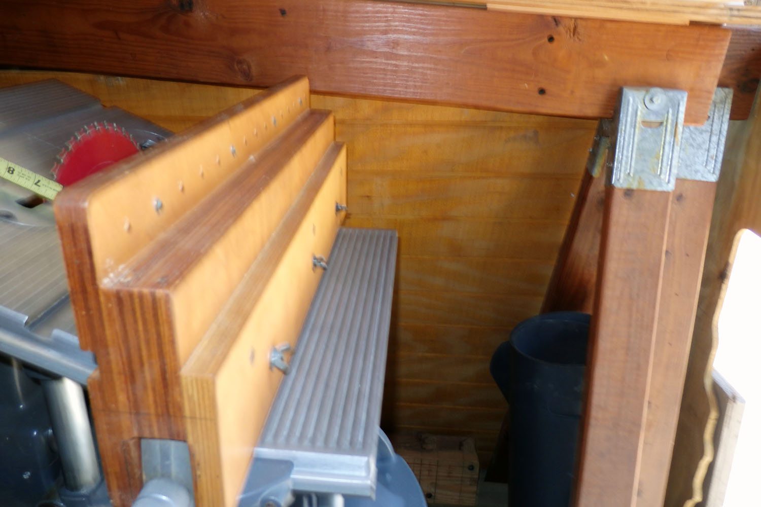

In addition to great suggestions you have already gotten, I can add you might need to make an auxiliary wood fence to add to your fence. With table tilted to 22.5 degrees, quill advanced slightly, and table butted up to my auxiliary fence, width of a rip bevel cut would be about 7" (to long edge).
For wider widths, just move headstock and table to left.
For narrower cuts (but still wider than with fence mounted to table), you might need to pad out auxiliary fence above the table.
For my auxiliary fence, I have a dado where I can use Shopsmith feather boards, and holes where can I can use my homemade wooden feather boards.
I did not try with lower guard in place ... that may not be possible.
And, are you making a hexagon or an octagon ... tilt table to 22.5 degrees for an octagon, 30 degrees for a hexagon.

- P8190113resized.jpg (258.4 KiB) Viewed 11828 times
- P8190115resized.jpg (166.22 KiB) Viewed 11828 times
- P8190116resized.jpg (244.79 KiB) Viewed 11828 times
- P8190117resized.jpg (169.11 KiB) Viewed 11828 times
