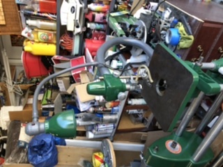

I just restored/rejuvenated my greenie tried some cuts and noticed a slow down in motor speed along with belt slippage smell... checked both belts... the filmed was fine but poly belt seems to be chewed up.. what would cause this as gilmer is tensioned to 1/8 to 1/4 deflection.

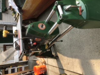

And not sure why pics are sideways... Done from iphone 🙄🤔

To set Gilmer tension, increase tension until the belt gets noisy, then back off slightly.
Oh the joys of technology being too active with zero intuition. Iphone (as well as other 'cameras') store an orientation in bits and then stores the pix in wide vs tall format. i.e. upper left corner is tl/tr/bl/br. The forum software ignores those bits and displays the pix as stored.
So hold the phone only one way when taking pix.( whatever way that will display properly when bits are ignored). Next time rotate the iphone 90° CW from that orientation when those pix were taken.
