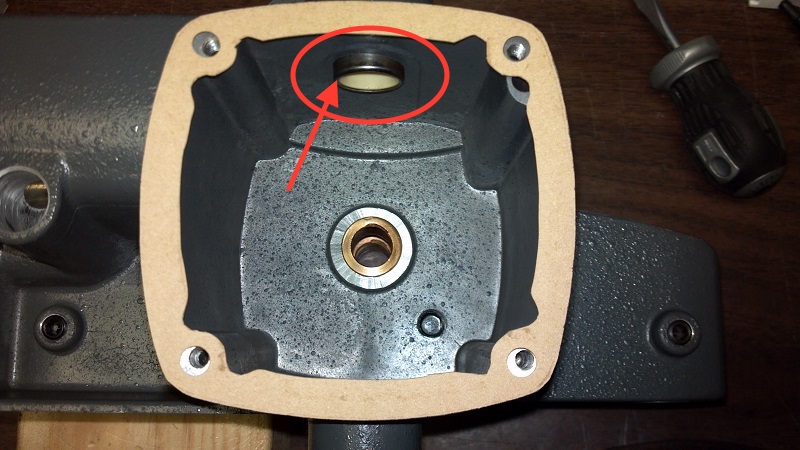

Okay, so I got busy building a shelf for my Shopsmith and didn't take a picture of the crankcase of the Jigsaw. So, I borrowed and image from the forum, and marked the bushing or sleeve I was talking about. There were two in the upper part where the arrow is pointing, with a gap between the two.
Jigsaw gasket and crankcase.jpg (139.07 KiB) Viewed 4463 times
I didn't see the bushing indicated in the exploded parts diagram as it does for the lower part of the case. So I pressed it up into the housing, closing the gap. This made it more free, but still did not get rid of the issue. I should be able to get back on it this weekend. I found a seal, indicated elsewhere on the forum from Amazon. National Seal part number 314267N.
Keep posting ideas, I'll keep updating my progress! Thanks for your help!

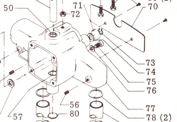

Re: 1984 Shopsmith 500 jigsaw question
jaxtell wrote:Okay, so I got busy building a shelf for my Shopsmith and didn't take a picture of the crankcase of the Jigsaw. So, I borrowed and image from the forum, and marked the bushing or sleeve I was talking about. There were two in the upper part where the arrow is pointing, with a gap between the two.
Jerry
"77" is the casting, so is not "50" the part in question?

Yes, part 50 oil seal (substitute) is the one I ordered. Hopefully National Seal part number 314267N will work. I'll update as soon as I get the part and get back to the repair.
