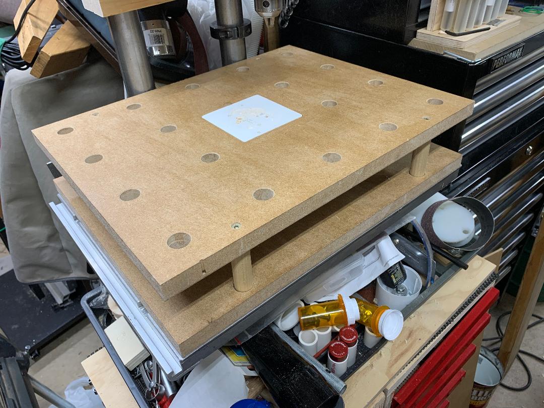

Re: 10ER - holes in table for drill press?
I have one of my machines setup as drill press full time. Most of that time I keep this drill table on it. It is not fixed in any position but clamped as needed.
drill press table.jpg (163.08 KiB) Viewed 2406 times

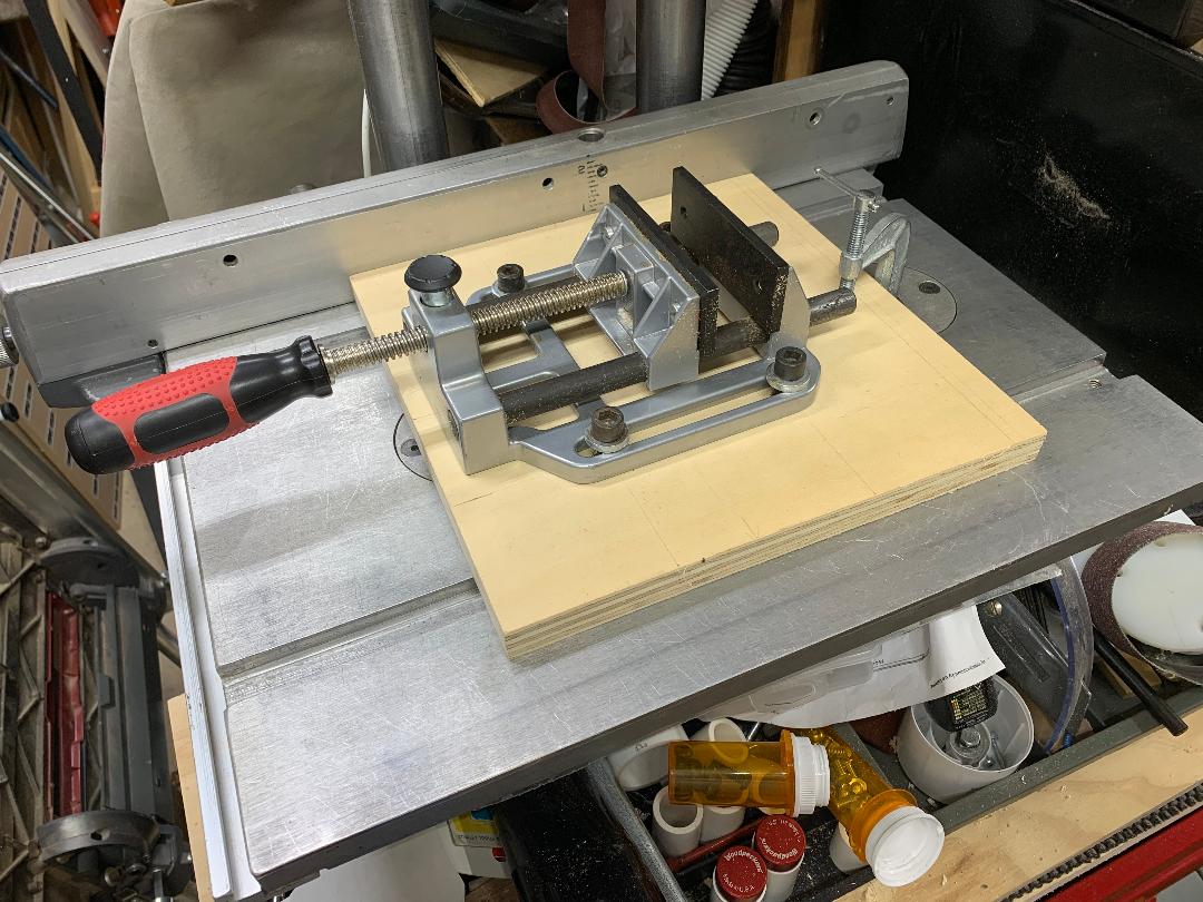

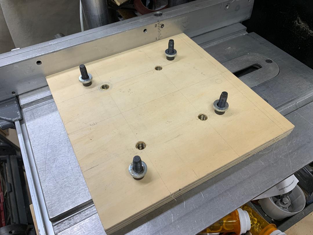

This next one is one of the smaller vise mounts tables. You can use the rip fence for locations and clamp as needed. This is about as small as I have since it was a multipurpose vice mount that I use with a router table as well. The vise is attached by way of some threaded inserts.
without vise.jpg (116.73 KiB) Viewed 2406 times
I have a collection of special add-on tops that I have found to be quite handy over the years.

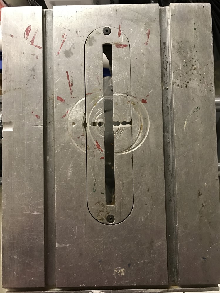

As was already said it is your shopsmith so you can modify it to your needs. Many of us may see drilling holes in the table as damage that cannot be repaired or replaced in the future since it is no longer made. Just like to see them preserved. I do like Ed's use of wood tops to fit his needs. The idea of adding a wood top does give you some versatility and protects it from a drill bit inadvertently hitting the metal of the table. That's not good for either the drill bit or the table. See what happens without this protection as shown on this Mark V table.
