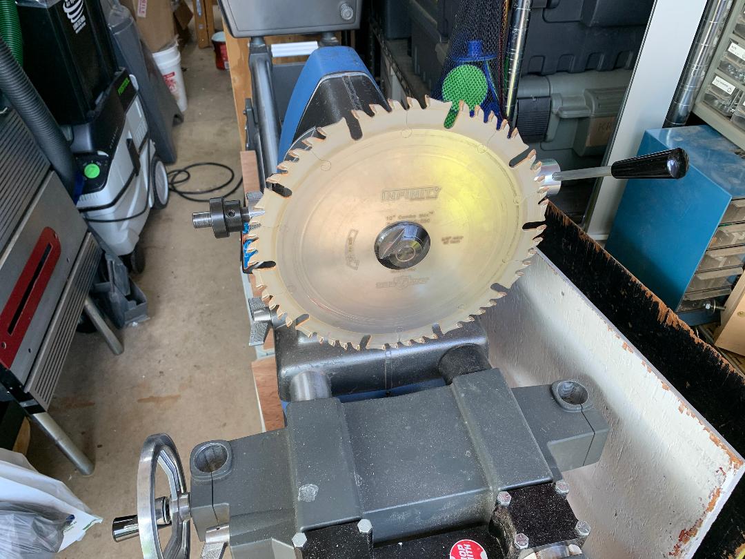

Re: Arbors
This is how I always change blades and have from 1976 when I got my first shopsmith.
You need to have the blade uncovered, as in not in the table or with a guard in place.
step 1.jpg (146.66 KiB) Viewed 5685 times
The blade can be mounted on either side but is best done on the normal location.

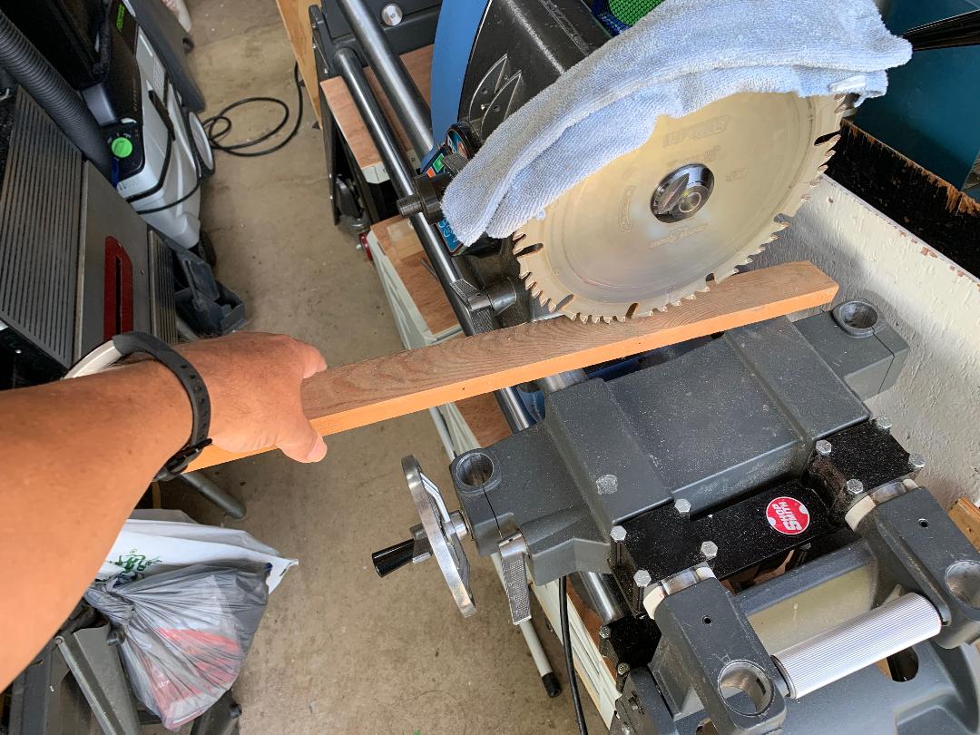

You can take a rag and fold it over several times if you think you might come in contact with the teeth. And yes they deserve respect.
step 2.jpg (151.78 KiB) Viewed 5685 times
Location of the headstock can be over the carriage or not.

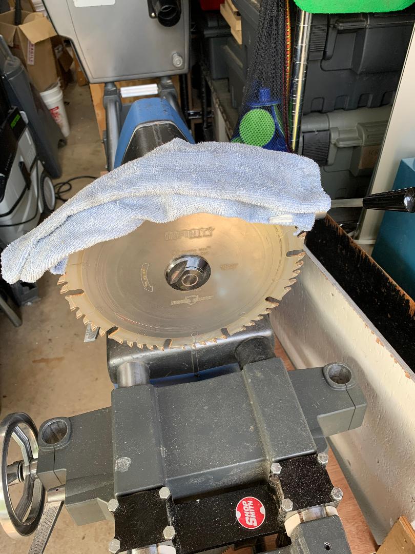

Next a scrap of wood either one by or 2 by and a couple of inches wide and say 2 feet long works nicely. You slide in place and then lever up into the blade. The teeth dig in and hold the blade from turning.
step 3.jpg (159.52 KiB) Viewed 5685 times

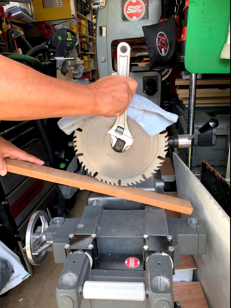

Taking the wrench of your choice you just turn the nut to loosen then do the rest with your fingers.
step 4.jpg (138.74 KiB) Viewed 5685 times
You can gain more advantage by using a longer wrench or at least using the length you have if needed. I have my grip shorten up to get the picture.
When you put the blade back on do not tighten like a gorilla, snug is good enough.
