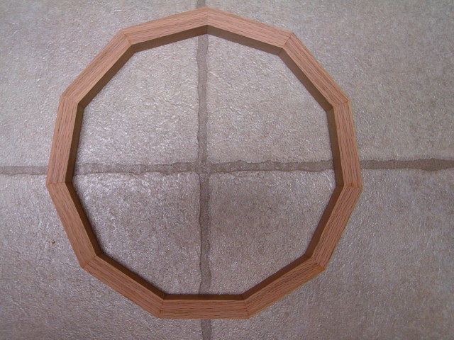

Here is a photo of an 11 piece frame I made to try out my MiterSet segment unit. Just selected the 11 segment hole and turned the Shopsmith Miter Gauge to correspond with the MiterSet pegs. Don't know the angle and really don't care. What I do know is - the segments fit exactly. Red Oak glued and clamped with a band clamp.

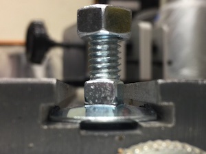

Elevator Bolt - T-Nut Alternative
Needing a solution faster than shipping allows (and lacking access to a mill at the moment), I'm trying an alternative...
Elevator bolts can be found at your local True Value / Ace Hardware store. The 5/16-18 size costs $1 USD and has a flange that's over 1" diameter. Use a cutoff wheel + grinder (or sanding disc) to get two straight parallel edges about 0.9" wide, to fit into the tee without spinning. A few pennies more for a washer and a nut. I'll report back when I've put some mileage on it.
The flange on mine is only 0.09" thick, so this isn't nearly as solid as a real T-nut. But in a pinch this gets my fixture in service today while I wait for the order from Shopsmith.

The elevator bolt worked like a charm. Just a few seconds at a bench grinder got it close enough to do the job.
When tightened, the square part of the head stuck up above the table maybe 1/32", but enough that you'd need to oversize or counterbore the fixture hole to ~13/32" to get things tight.

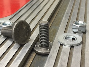

I set out for a cleaner solution and came upon tee nuts that many of us have used elsewhere for about $2.75 each. In the 3/8" size, they're big enough to fit the t-slot with just a light kiss on the bench grinder to add flats on the sides. However, they're tall, and about half of the threaded section needs to be ground off to be flush with the table. (Or, oversize your fixture hole and use a washer.) More commentary on nuts vs. studs below...
Finally, visiting a slightly larger Ace Hardware store yielded something called weld studs. The 3/8" size works well with zero modifications for about $1.60. Bingo!

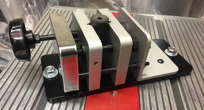

The end result:
While this looks odd being askew, I opted for this to make storage compact instead of adding a fixture plate. I can align one axis via the slot, then move the table in/out for the other axis. Both jaws on the vise move in unison, auto-centering different-sized pen blanks under the drill. (This pen vise is by DCT, and I quite like it for the price.)
FWIW, some tidbits I picked up from the world of machining about T-nuts vs. T-bolts (studs)...
When you use a T-nut, there is a good chance that your bolt will be too long and actually poke through the nut, pressing against the bottom of the slot and wedging the nut in the slot but not necessarily pulling your fixture tight to the table. For this reason, T-bolts (studs) are more forgiving because the nut goes on top.
Also, the solutions here aren't kind to the t-slot - definitely for light or temporary use. The pressure is applied to a narrow spot in the slot instead of distributed like the longer, official t-bolts/nuts do. That said, you probably don't need to clamp anywhere near so vigorously as a machinist, so this may not be a practical problem.
