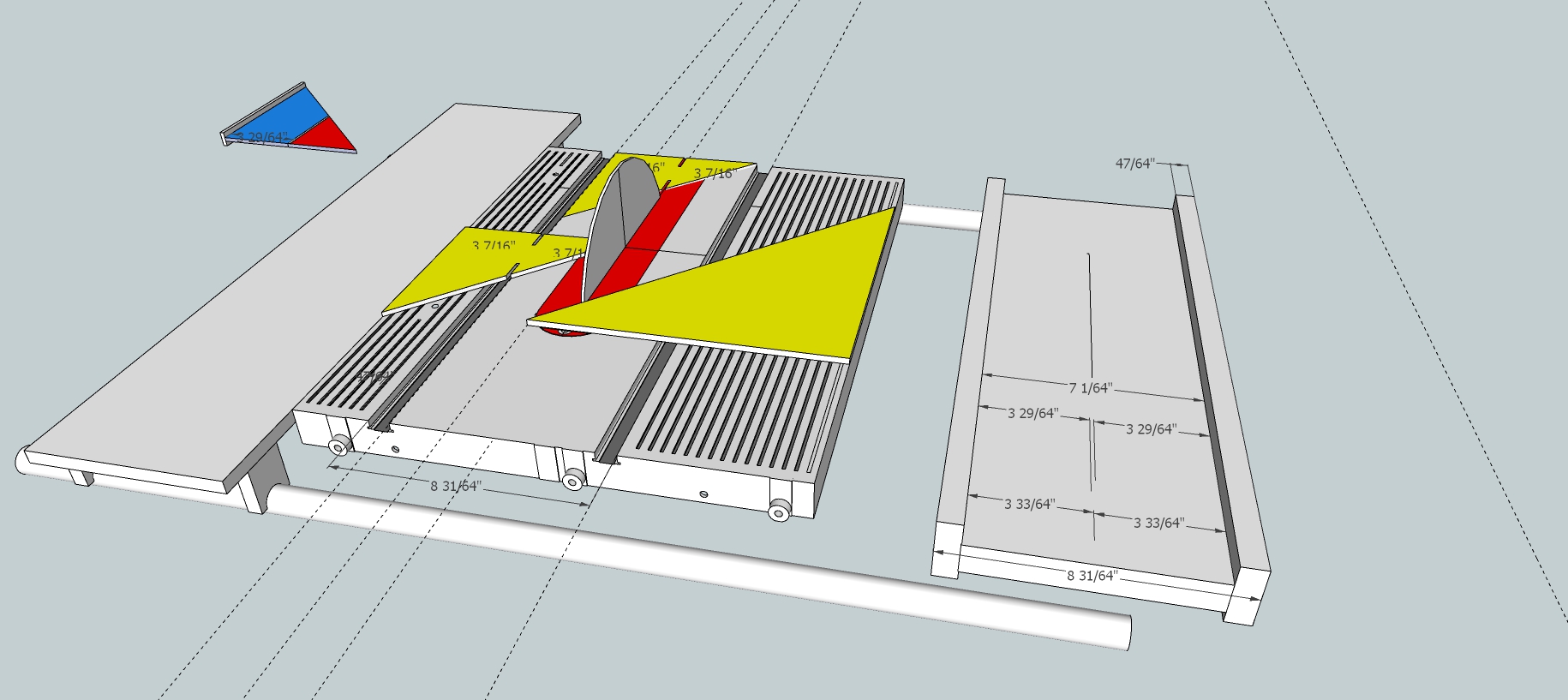

Re: Main Table Numerics
Main Table Numerics
Main Table Numerics
Main Table Numeric Coincidences.jpg (360.26 KiB) Viewed 1030 times
