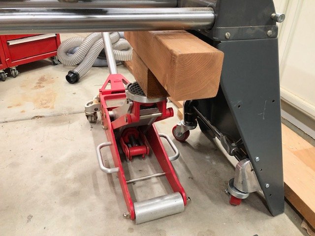

Yeah, I still don't get why Shopsmith recommends flipping the Mark V over to install the new casters. Would you turn a CNC or a Bridgeport mill or your car upside down to do anything on them? Similar to what you did, I used my car floor jack and some offcuts to raise one end just slightly. It only required a few pumps on the jack handle to raise it just off the floor while I did the replacement. It was fast and far less disruptive to the alignment since I only had to raise each end slightly, i.e. less movement than when the cam locks are turned on the caster assemblies to raise/lower the Mark V.

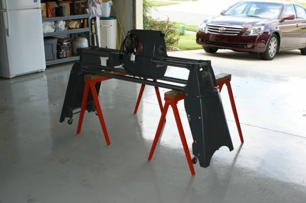

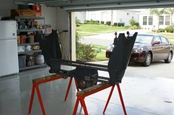

turn it upside down this way.
SS upside down.jpg (72.51 KiB) Viewed 1844 times
SS on saw horses.jpg (91.71 KiB) Viewed 1844 times
Bill V

Still seems like a lot of potential racking and risk of an accident in flipping it over, but maybe it is just me. I know everyone may not have a floor jack or suitable means to safely lift the Mark V so I guess Shopsmith has to err on the side of providing instructions that don't utilize any tools not shipped with the upgrade (or readily available).
