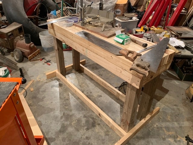

Here’s my first real project on my “new” 10ER. I decided since I have a capable woodworking power tool I need a woodworking work bench. The top is 12 2x4’s glued and screwed to make a 3.5x18 inch beam. It’s rough and unfinished, but I think it will work for my purposes. Ripping all the lumber (except the legs) out of 2x12’s gave me ample time to get acquainted with the table saw function.

are you planing on flattening the top ? if so what method ?

Yes, I’ve got a couple jack planes coming.

I wanted to do the top without screws to leave room for future dogs and hold-downs, but I have no good way to clamp something that wide. Also, I wanted to get it done and get to building things on it rather than shopping for clamps (plus I'm cheap). However, I put the screws at measured consistent locations, so I'll know where they are and can drill around them.

Will you camber the iron on one of the #5's.
Makes it easy to remove material quickly to flatten the top.
I did that with a #4 when I built my workbench. viewtopic.php?f=6&t=12550

The iron on the number 5 came somewhat cambered, and I've got it set for a relatively deep shaving. I'll have to get a picture of the leveled bench up.

After a long wait (but I doubt with bated breath :D ), here’s a picture of the bench with flattened top. It’s not perfect, but I can always work on it some more.
