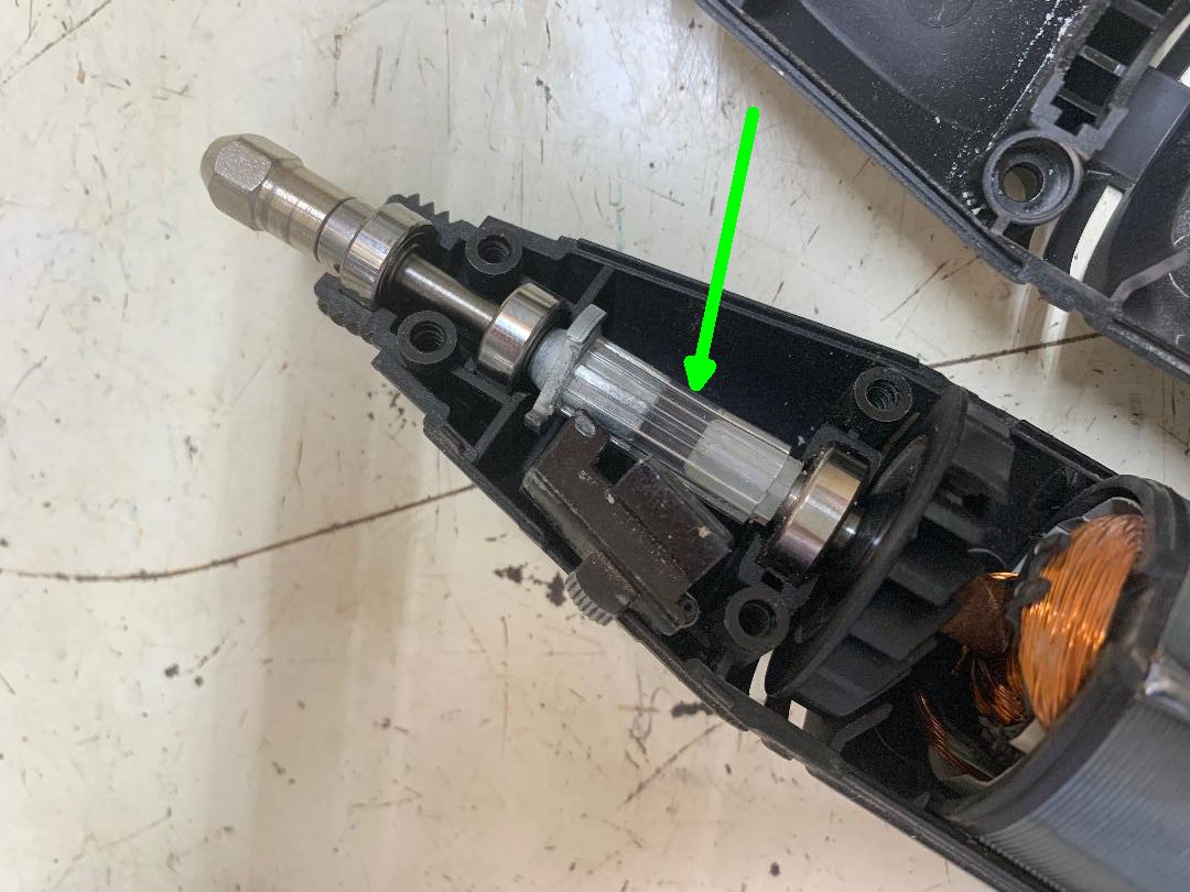

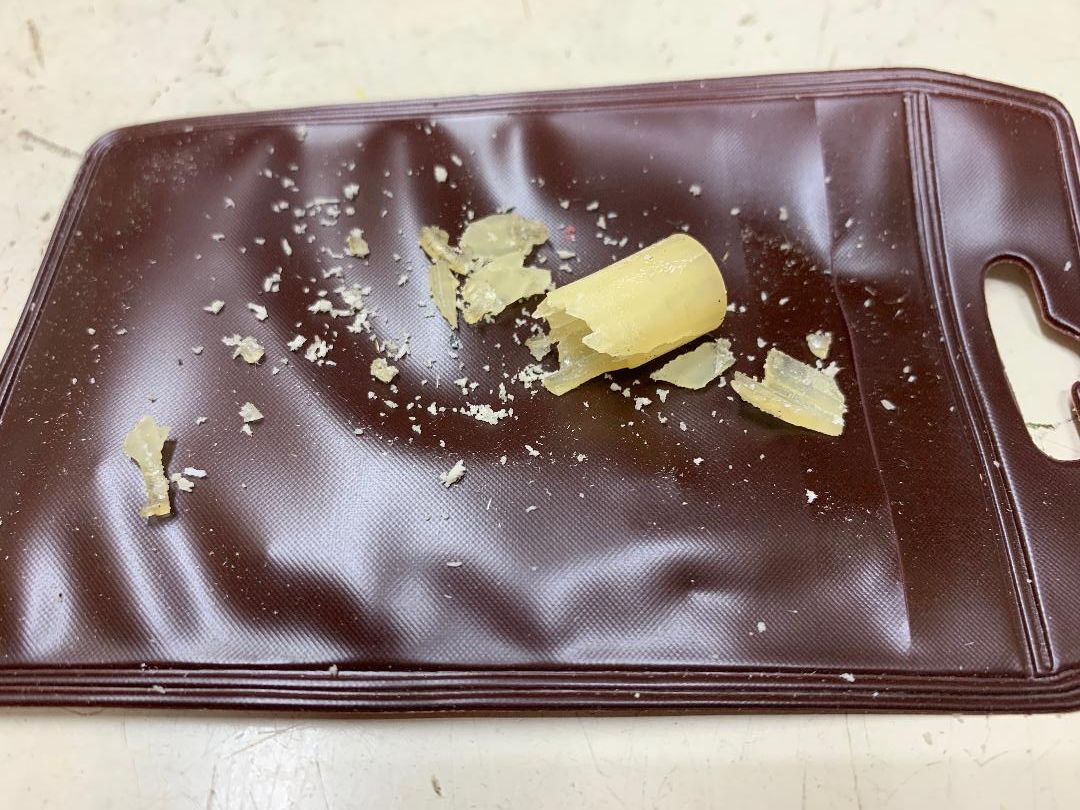

I don't recall when I got this but it has been a very long time ago. This was the first problem I had with it. Just old and brittle it looks like.
Found what I hope is a replacement on line and they will be here tomorrow. Right in the middle of a project and stuck until I can get it working again. I did think maybe I should get a new one but for the pair of parts it is costing me only $8.56 and delivery tomorrow.... Just hope I guessed at the right one, don't have a chart with Craftsman to Dremel models but it looks right.

I'm happy this went so fast, the new part arrived, I installed it and back in business.

I had the same part crumble like yous did a few years ago. I put in the same replacement part and it has been going strong ever since. I tend to use the Craftsman tool over the Dremel tool. A feature I have on mine is the "Drill" style chuck which is great for quick changes.
