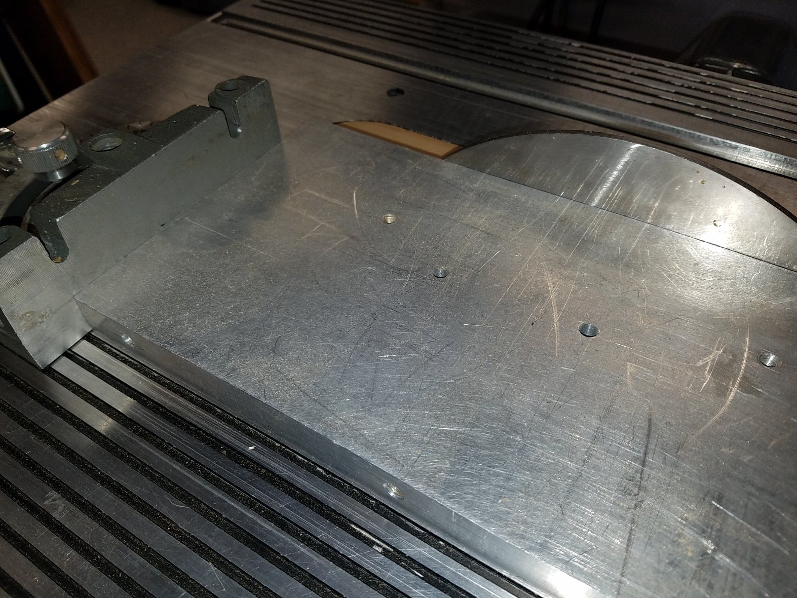

As a starter in this effort, it is necessary that the carriage (which carries the table) and the headstock (which positions the blade) are in proper position too achieve that relationship. By design, the rubber bumper makes that relationship relatively easy to achieve. Simply push the carriage and the headstock together until both contact the rubber bumper. Of course, if you have no rubber bumper installed, this condition is difficult to achieve.
On my machines which are both 510s, my rubber bumpers measure 1 3/8" (1.375"). This is what that mating looks like.
If this relationship does not exist, it is uncertain whether you can achieve what I consider proper alignment.
Proper alignment being (in part) the saw blade parrallel to miter track and nearly centered in the table cutout.
The sketch presented earlier in this thread depicts what I believe the table, blade and insert should look like under these conditions.

Likewise, there has always been significant discussion about how to get to a properly aligned machine. Most have found a way that suits themselves. Some have not.
A different look at this.

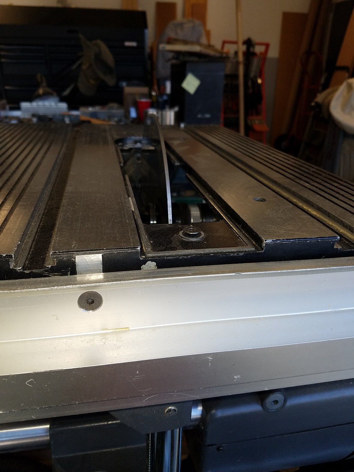

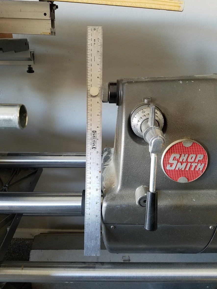

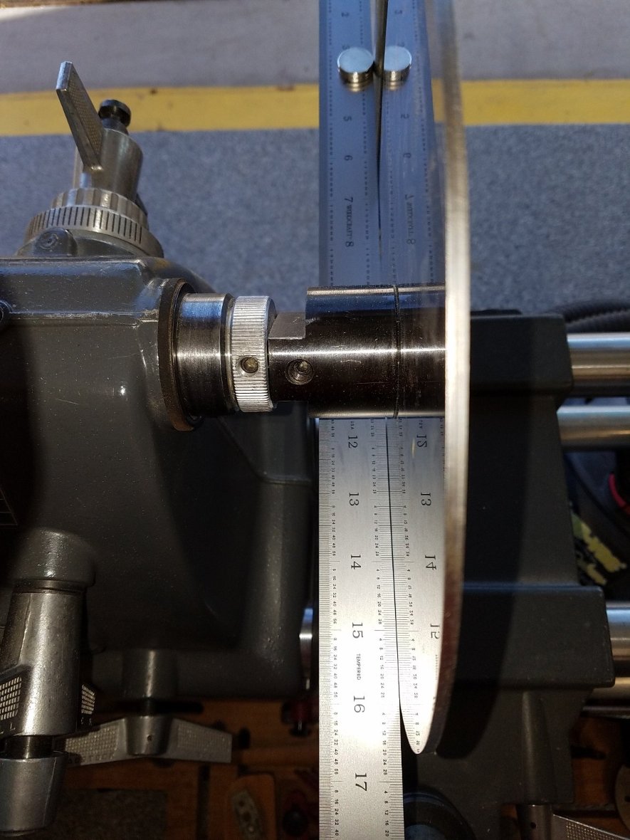

Then there is this, A straight edge hung between the two table legs showing that the left face of the saw blade (here an alignment plate) is on the same plane as the left edge of the table legs.
All of this with the rubber bumper contacting both the headstock and the left edge of the carriage.
If at this point you mount a main table mounted the alignment plate will protrude through the table insert cutout very, very near center.

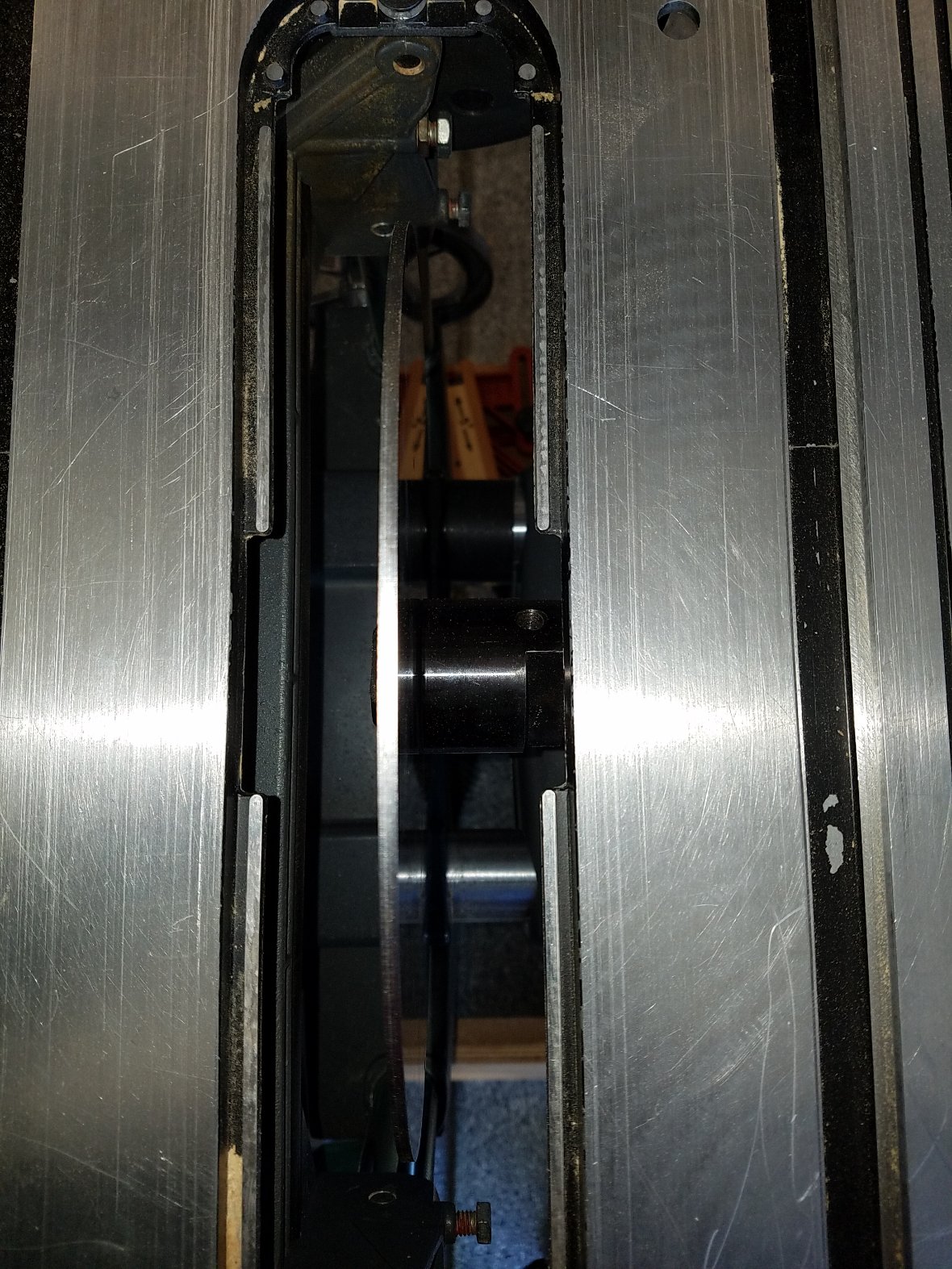

If you have done that depicted in these few images and the blade (alignment plate) does not protrude properly through the table insert (cut out near center) you have a problem. A BIG PROBLEM.
This is not a coincidence. The Shopsmith was designed to do this in this manner. If you set up differently then expect different results.
Note the relationship of the alignment plate and the shallow saw kerf through the "center" of the table insert

The final question. Is it properly aligned? Will it function properly.
Based on these images, I would say I am ready do go to work. Change to a saw blade and mount the rip fence and then let it rip.
No calipers, no dial indicators just a simple setup block.
