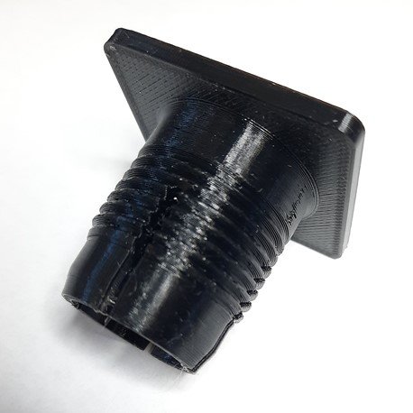

516457 Locking Collet (3D printed PETG Plastic)

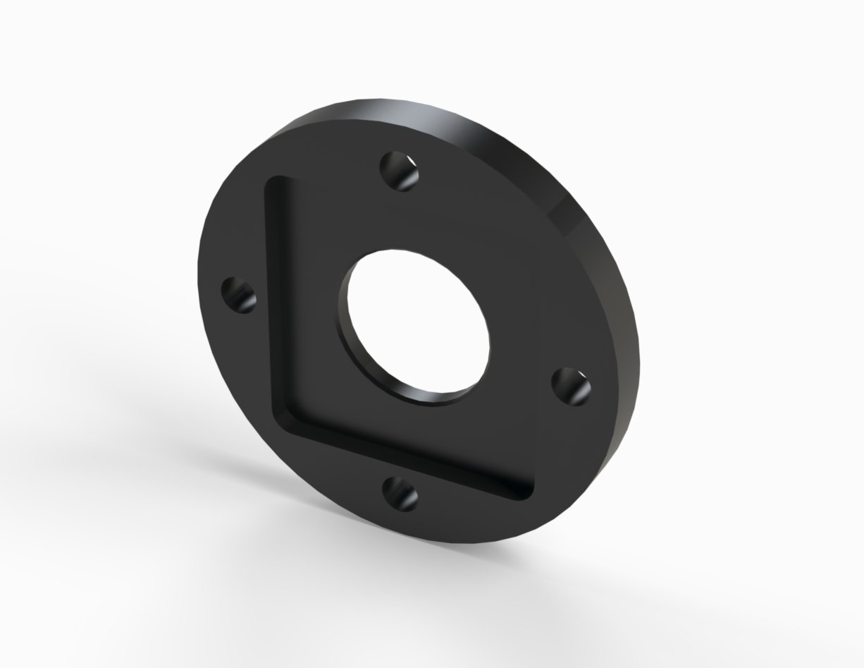

516459 Collet Plate (3D printed PETG Plastic)

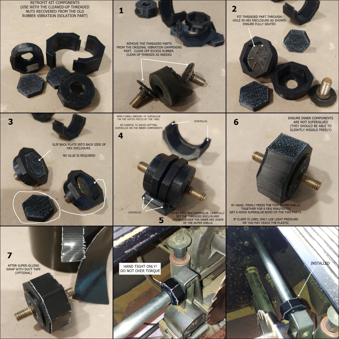

517988 Isolator (This is a 3D Printed set of parts that replaces the isolator, requires you still have the two threaded bolt components from the Isolator)

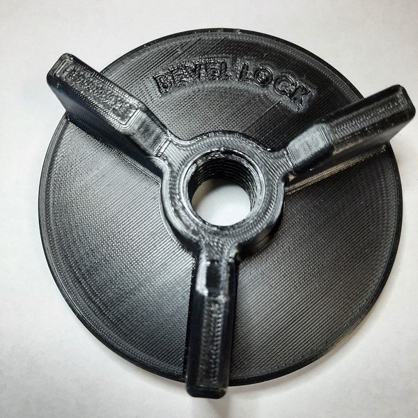

Item for the Bevel/Angle Adjustment Assembly:
516461 Locking Hub (3D printed PETG Plastic)

I was shown an actual version of the Locking Collet 516457 by one of the members and updated the 3D printed part. This is the updated (Corrected version now.)
Sawsmith 2000 516459 Collet Plate
SAWSMITH CARRIAGE COLLET PLATE 516459.jpg (29.38 KiB) Viewed 2107 times
Sawsmith 2000 517988 Retrofit Kit for Isolator
ISOLATOR 517988 - VIBRATION DAMPENING CONNECTOR RETROFIT KIT.jpg (285.33 KiB) Viewed 2107 times

Sawsmith Clamping Hub 516461 - Bevel Lock
Sawsmith Clamping Hub 516461 - Bevel Lock.jpg (102.3 KiB) Viewed 1350 times
Sawsmith Locking Collet 516457 - Carriage
Sawsmith Locking Collet 516457.jpg (27.52 KiB) Viewed 1350 times

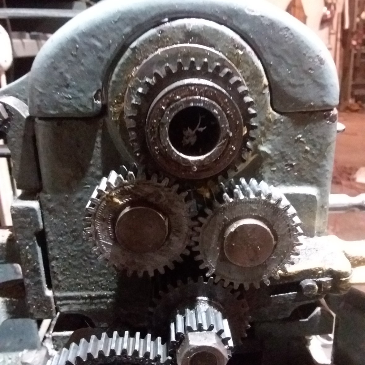

New to forum... so might be less than knowledgeable about specific parts you are printing... But will speak to the durability of 3d printed parts... about a yr and half ago I had a gentleman in US print a couple of gears for my Logan metal lathe... and i am very impressed...run very quiet and so far no signs of wear... good work ... everyone running 70 yr old equipment needs to know a expert in auto cad and 3d printing

Sorry pic rotated for some reason... 2 gears on left

Cool. (UPDATED 4-17-24)
I'm assuming the material was different that what I have available for printing. I typically use PETG plastic (strong like ABS but UV resistant). However, the parts I'm printing have little torque stress, unlike gears. Impressive!
