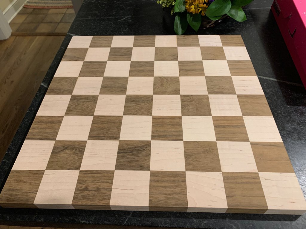

Here it is sanded but not yet finished.
It will get some varnish.

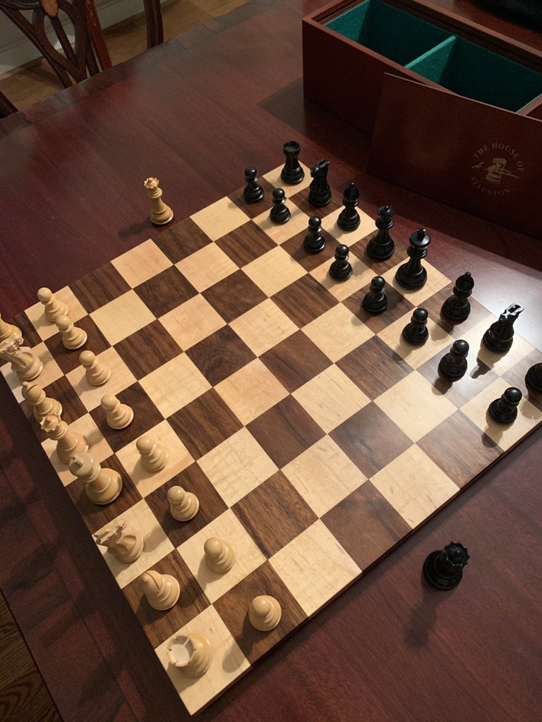

Well, here it is with the chess pieces my daughter purchased.
