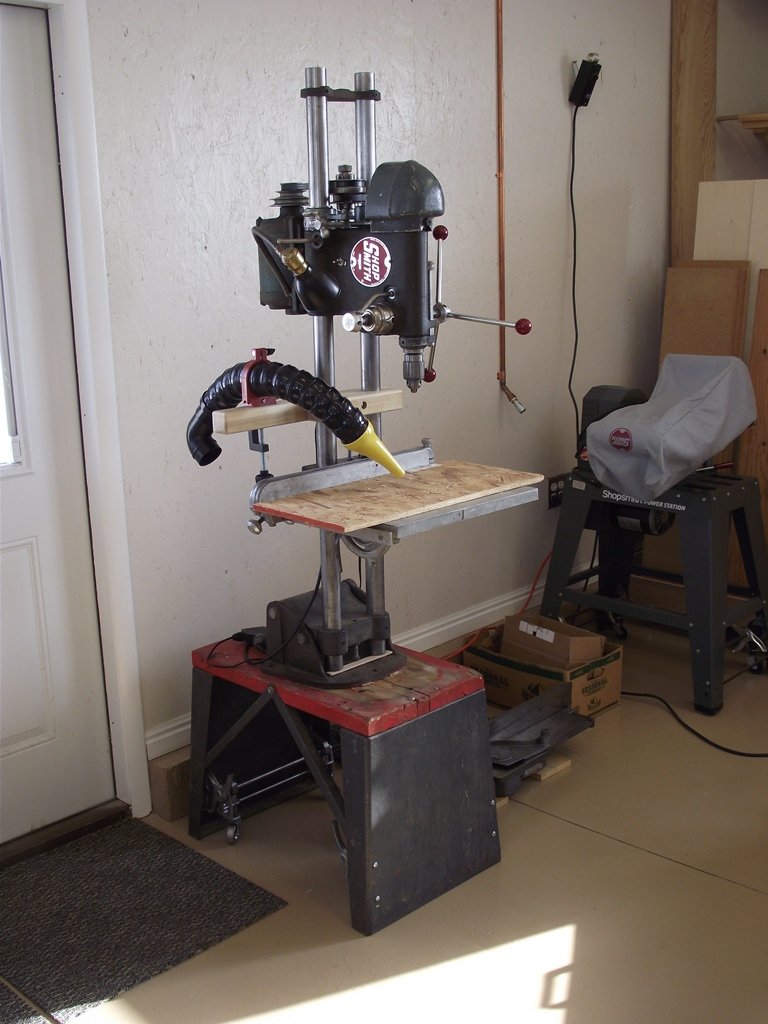

If you don't want to attach the drill press to the wall, do what I did. It is very stable and you don't loose any more floor space than you would attaching it to the wall.

I really like that base unit, John. Can you tell me its origin?jsburger wrote: Mon Nov 30, 2020 1:58 pm If you don't want to attach the drill press to the wall, do what I did. It is very stable and you don't loose any more floor space than you would attaching it to the wall.

It is a cut down model 10 base.

I should have guessed that but I did not look close enough at the red platform. I thought it was all metal. I still like it.

That is the original base that the 10ER was mounted on. I just cut the wood top down so the 45º angle braces met in the middle. That way they can both be attached with one lag screw. It was done as a down and dirty proof of concept. The machine I am refurbing now will become the drill pressdusty wrote: Mon Nov 30, 2020 3:18 pmI really like that base unit, John. Can you tell me its origin?jsburger wrote: Mon Nov 30, 2020 1:58 pm If you don't want to attach the drill press to the wall, do what I did. It is very stable and you don't loose any more floor space than you would attaching it to the wall.

I'm sure John will answer it but his Drill Press Model 10ER is mounted on Shopsmith Bench Ends with shorter boards. I have seen one mounted to a wall but given the choice I would prefer the set up like John's.
