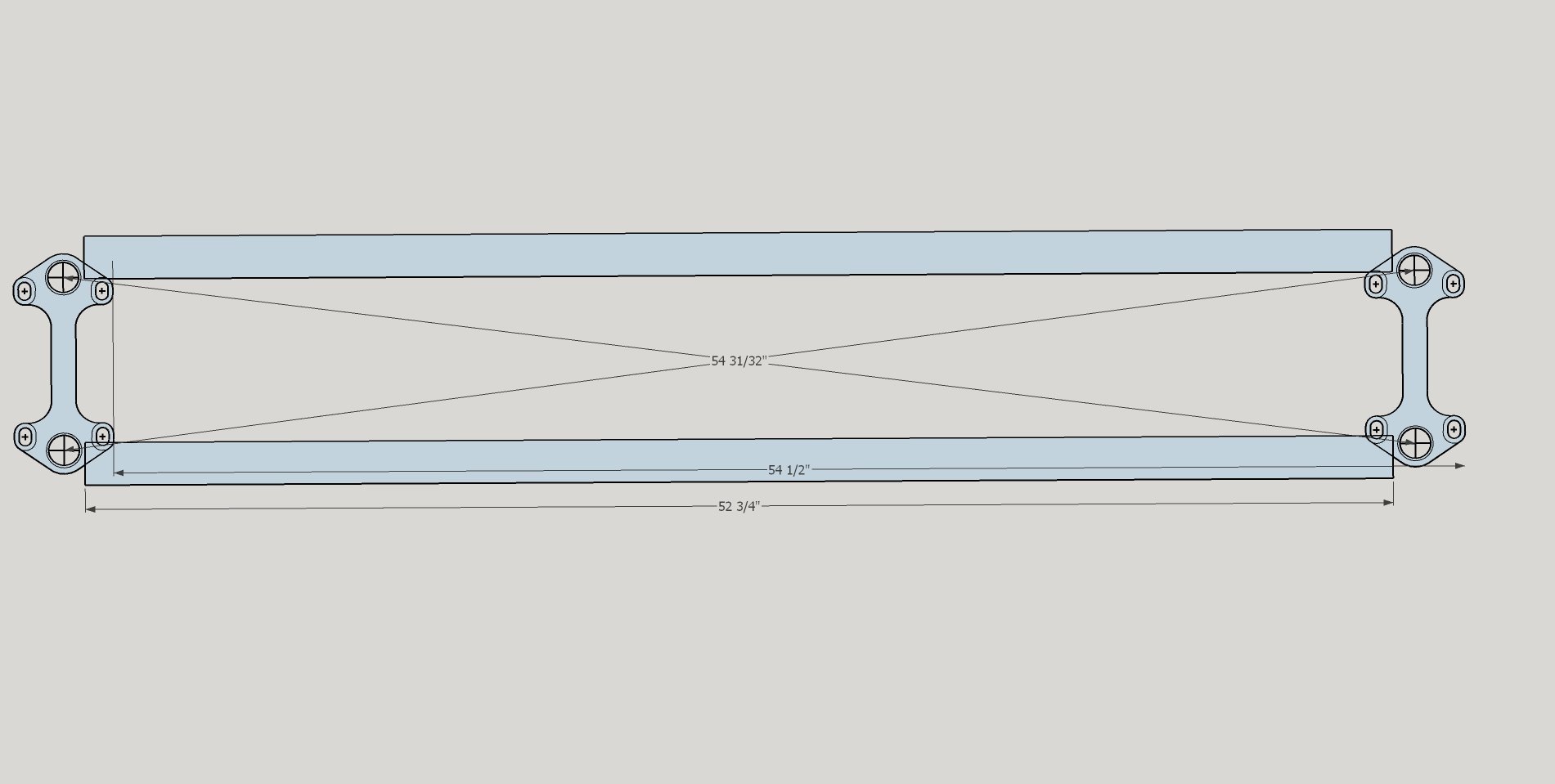

I would sure appreciate some assistance. If you are one of those who finds that they can not interchange their extension tables and maintain alignment of those tables would you please post or email to me the diagonal measurements that you get when performing the measurements depicted in this attachment.
The numbers will likely be different than mine but the two diagonal measurements should be very, very close to the same.

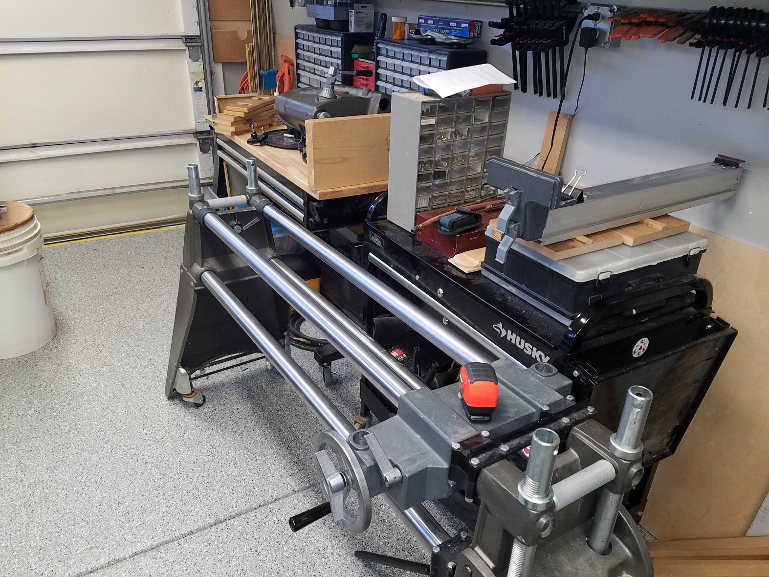

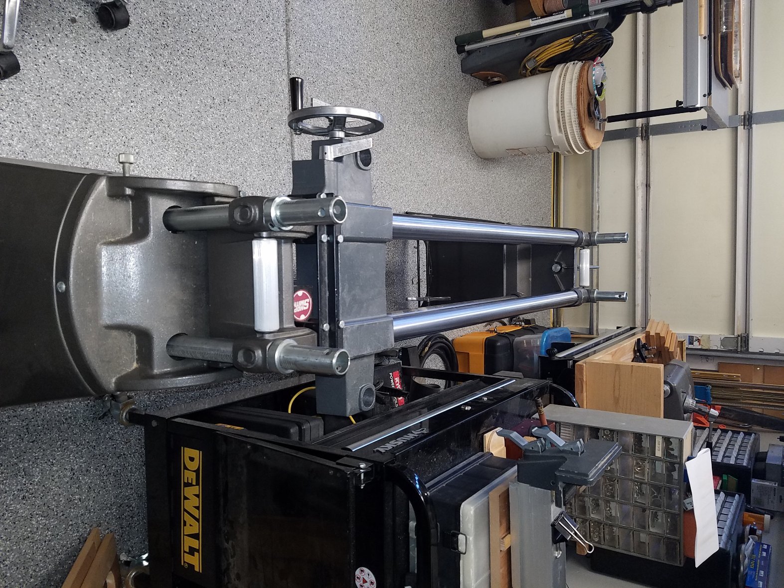

Re: Request for Assistance.
JPG wrote: Fri Dec 11, 2020 1:25 pm I would be interested in how one measures THROUGH the headstock.
Doing so requires a small amount of imagination and some physical effort. To do it you really need to want it done.JPG wrote: Fri Dec 11, 2020 1:25 pm I would be interested in how one measures THROUGH the headstock.

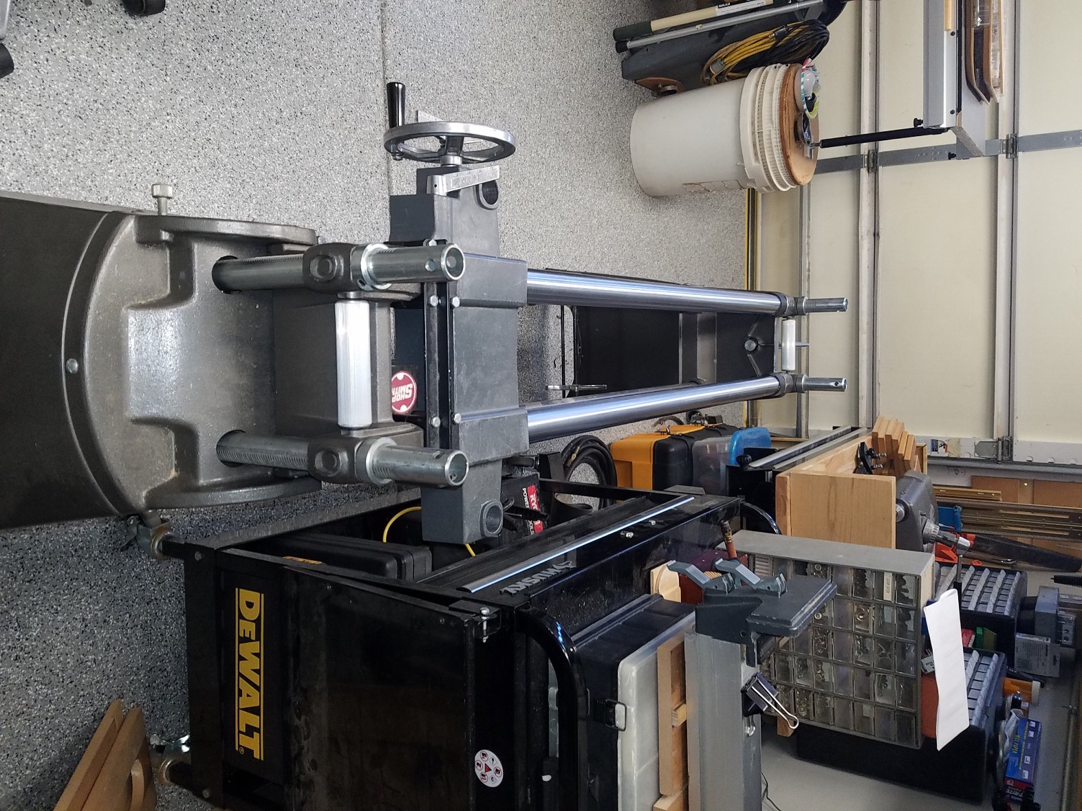

Using a tape measure and the stripped down 510 pictured in the previous post I measure 55 7/8" and 55 7/8". The carriage slides back and forth with only finger tip pressure.
Measuring center to center I get 54 11/16" by 54 11/16".
I am pleased with the consistency of my measurements. Based on this observation ( as well as yours) I would expect extension tables to be interchangeable. FWIW - This is the Shopsmith that I have been using as a router table and drill press and the one that gets rolled around (which should not be a challenge since my floors are smooth and level except for the two expansion joints).
