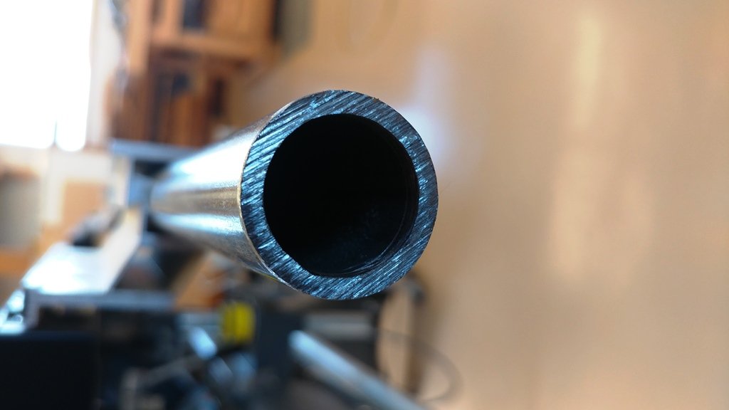

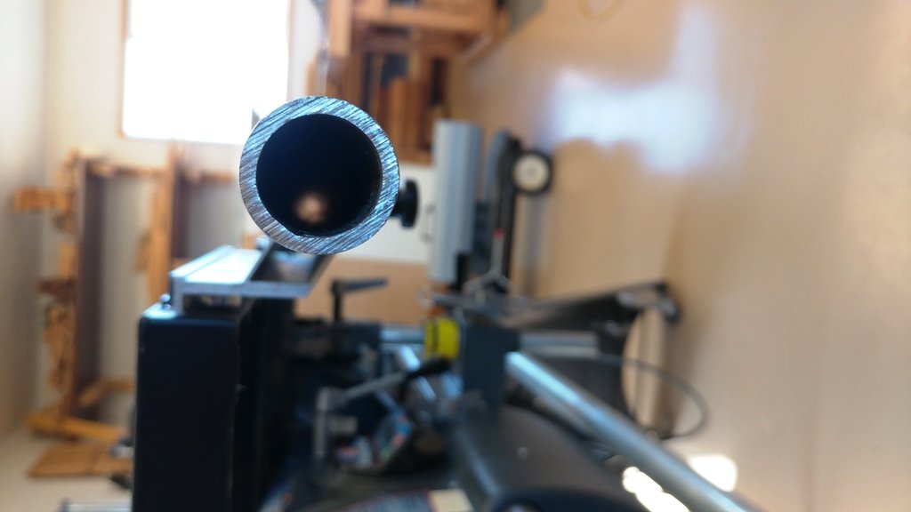

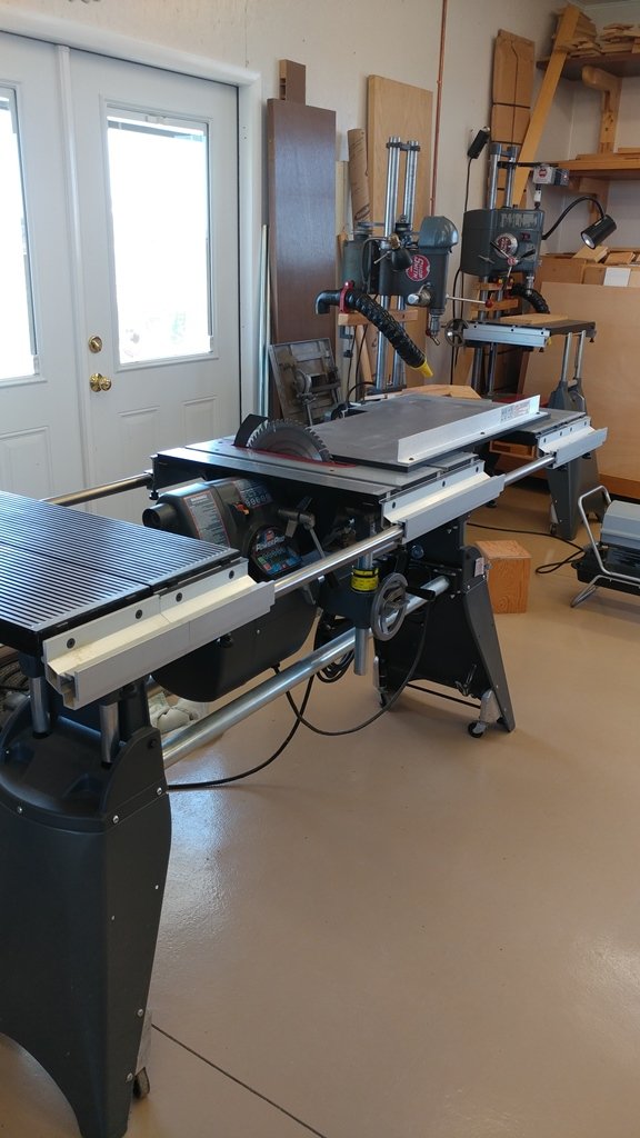

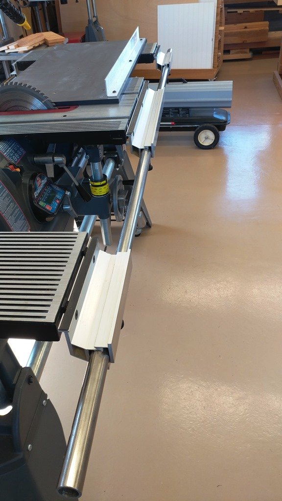

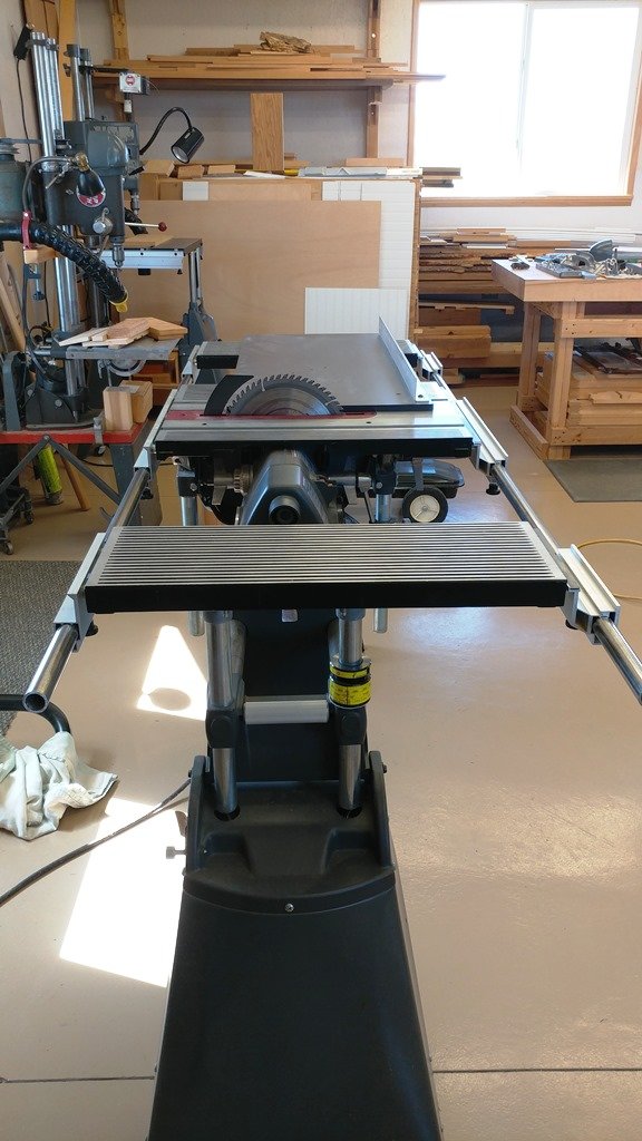

I got mine from Metals depot. They are Stainless Steel with a 0.120 wall thickness. VERY stiff. As Dusty said, rolling them on a flat surface they are perfectly straight.
I bought them 6' long. That allows an extra floating table on the outboard side of one or the other of the fixed tables.
