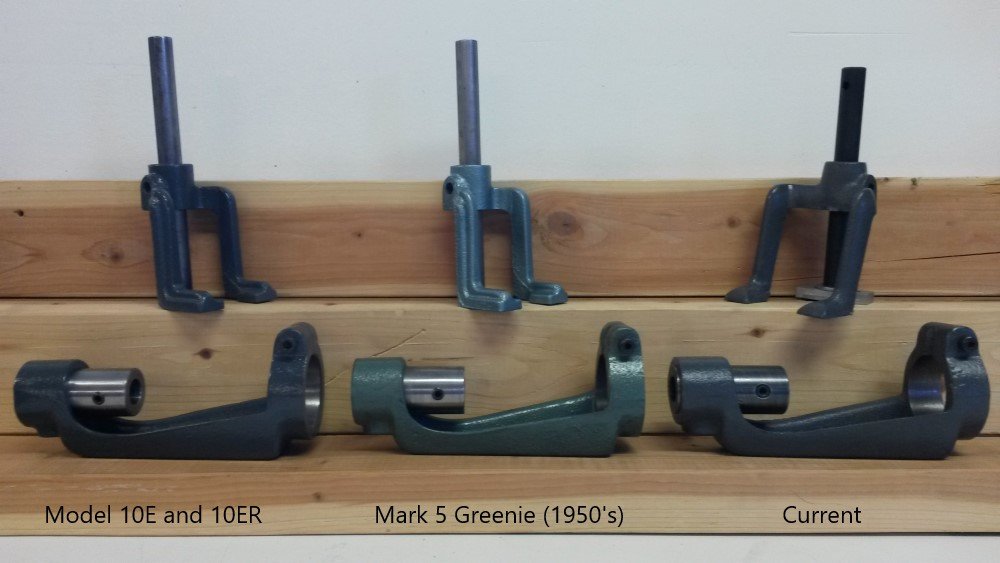

Hopefully this will help in understanding the differences of the Mortise and Hold Down for the Model 10's and Mark series tools. First off the Model 10's and the Mark series tools all have the same Quill and Spindle diameters. The Mortise attachment made during the Model 10 production differs only in the size set and cap screws used and therefore the Allen wrench size. They came in Gray, greenie and Goldie colors to match the Tool color of the time. The Hold Down besides the color has had three versions again dependent on the set screw screw size for the first and second versions. The third version was recast differently as shown in the picture below and the current Hold Down has the threaded post with a washer and "T" nut for the "T" track in the fences. It can be used on older fences that have the mounting hole instead of the "T" track. Simply invert the post or remove the washer and "T" nut.
In the picture below are three Mortise and Hold Downs. The set on the left is from the Model 10 production era. The center set is from the Mark 5 Greenie era and the set screws and cap screw changed to use only the 5/32" Allen Wrench size. The set on the right is the current version. The Mortise is the same as the Greenie one except the color and the black protective coating added to protect the bare metal sleeve as was done with many bare metal parts beginning in 1964. For the current version, note the change in the Hold Down casting besides the "T" nut. This version of the Hold Down casting was used prior to the addition of the "T" nut. Originally this one had just the post and I purchased the new threaded post, washer and "T" nut from Shopsmith to upgrade it for use on my Mark V 520.
Model 10 - greenie and current.jpg (74.06 KiB) Viewed 3113 times
One thing to note for Model 10E users that have the early clamp on Gauge Collar on the Quill. The collar needs to be moved back on the Quill to allow the Mortise to be attached. To use the Hold Down you would need the Rear Clamp adapter for the original 10E fence or use a later version of the Model 10 fence that has the rear clamp and the Hold Down hole in it.
