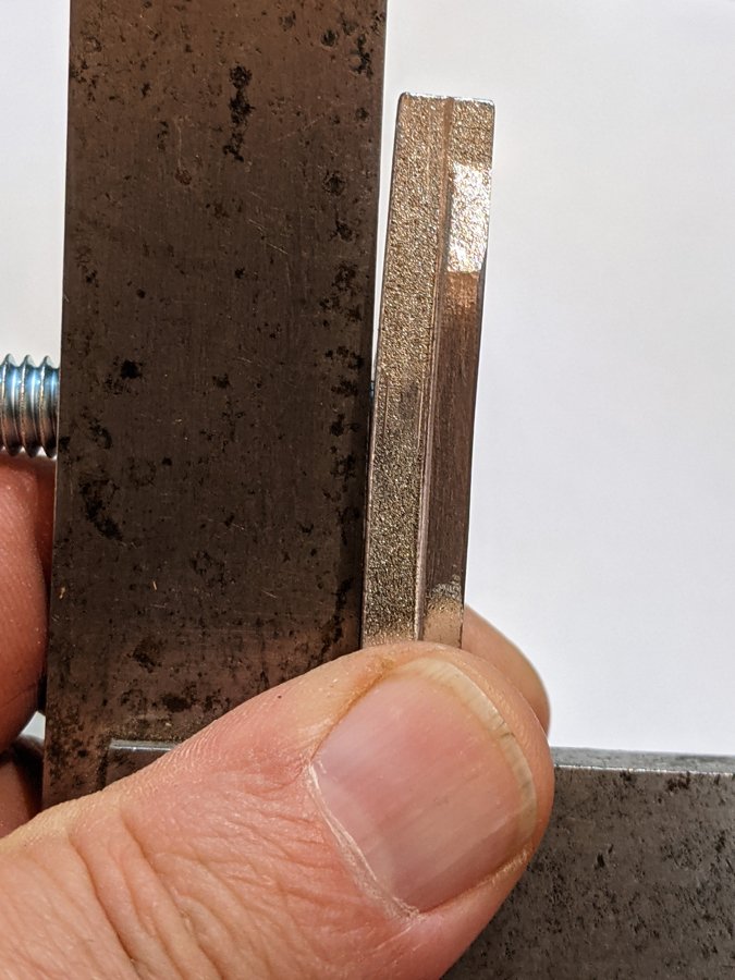

I bought a fence-mounted featherboard for my 520 from Shopsmith during the recent sale. It looked great in the package and I put it in the featherboard drawer until today, when I had occasion to use it.
I was perplexed to find that the T-nuts wouldn't fit into the slots on the fence or the table, sticking about halfway. First I thought there were manufacturing burrs or something needing cleaning up, so I smoothed edges with a file and did little chamfers on their little noses. No effect. After more monkeying around I put them on a straightedge and found they were both nearly a sixteenth out of square at the centers.
It appears that in swaging the nice fat 5/16" threaded rods into the center holes on the T-nuts, the operator pressed the nuts themselves out of square. Then no one bothered to test the products before packaging.
The material of the T-nuts seems unusually soft for this kind of application as well, close to pot metal. Not worth getting replacements of the same thing, I'm thinking.

Here's an illustration:Pictures, please.
Re: Bent T-nuts on new product
Ok, so that's the flat head of a T bolt up against a square and the threaded part of the bolt behind the square, right?
That's bent pretty bad, like it was overtightened with a nut while it was in the slot, but that would take some mighty tightening on something normally tightened with a small knob or nut by hand. And you found this on multiple bolts too? At 5 bucks a pop I'd want my money back.

StevenAyres wrote: Thu Dec 31, 2020 4:41 pmHere's an illustration:Pictures, please.

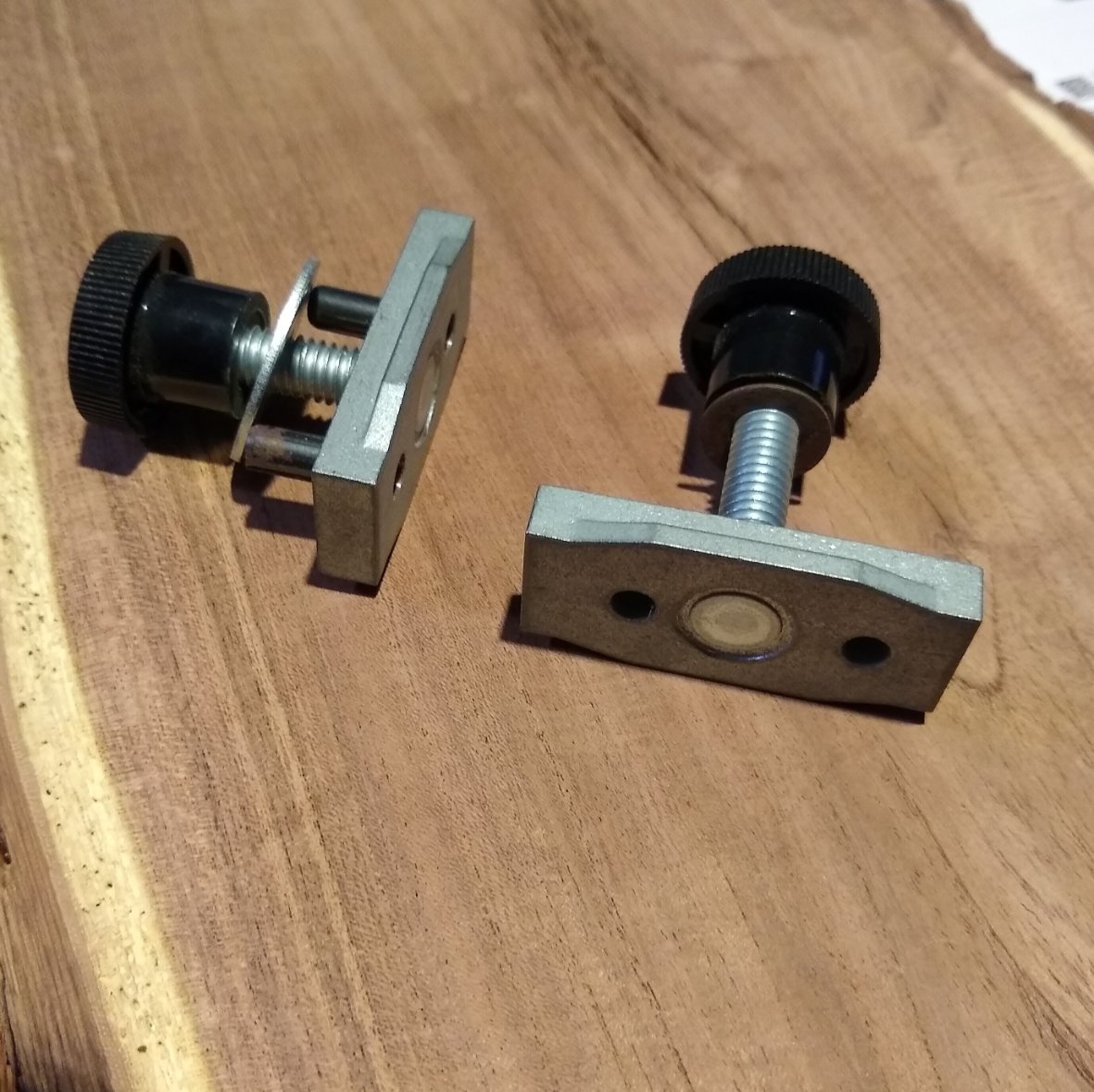

WOW. I didn't believe it! That is definitely worth contacting Shopsmith.
Unreal! This is what they used to look like, one shown with the optional roll pins used in some applications:
These seem different in every possible way from the OP's new ones.
- David

In the OP's picture the overall thickness is less. But, the stud is on the wrong side. How can that even start into the T track?DLB wrote: Thu Dec 31, 2020 5:51 pm Unreal! This is what they used to look like, one shown with the optional roll pins used in some applications:
