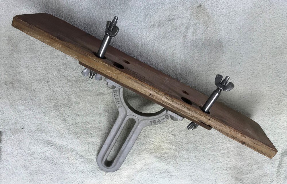

Other than the broken parts that need replacing for Lathe work the only other thing I don't see in the pictures is the Extension Table and its bracket plus hardware. For your 10E it would have the Wood Extension Table with the parts as shown below.
This one is the early version board with wood screws holding the board to the top bar (P/N 109-4) of the bracket assembly from underneath. Later 10E Wood Extension Tables were held in place by flat head/counter sunk wood screws going through the wood to hold the parts (wood, top bar & Bracket) together.
If you need to replace the Extension Table Assembly consider getting a Metal Extension Table Assembly including the correct Tailstock and Fence with rear lock. They are more common and easier to use for cuts needing the fence on the extension table.

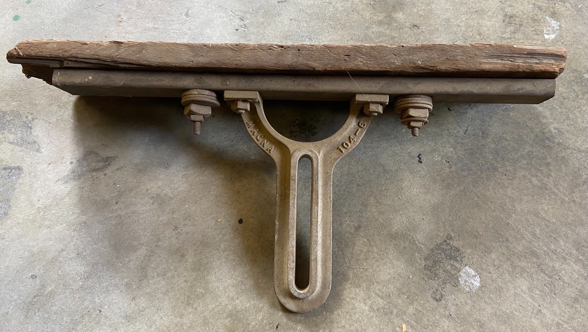

Also, I do have that extension piece.

Re: Serial Number 3068 - Model 10E
Essentially they would be interchangeable.(very few that ain't)
Interesting washer/nut stack.
- Posts: 4534

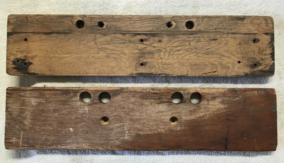

The bar for the Extension Table does not look like the original. Yours is longer, spanning the wood top farther. I agree with JPG's comment Interesting washer/nut stack. Not sure what that is for. Those holes hold the pins for the fence to attach as shown in the picture in my previous post. The wood table top measures 19-1/2" x 4-1/2". As described in my previous post there were two versions of the hole sizes. In the picture below is the two versions with the early one on the bottom and the later one on the top. Only the four larger holes in each of them are original. It is any ones guess what the other small holes were used for by previous owners in the later version but on the early version the countersunk holes were used to attach the bracket incorrectly making it un-useable for the fence. That's how I received it.
I have made several replacement wood tops and prefer the later version.
Parts from serial number 21898 would fit your 10E. As I said before some parts can be replaced by later versions individually while others must be replaced as assemblies.
