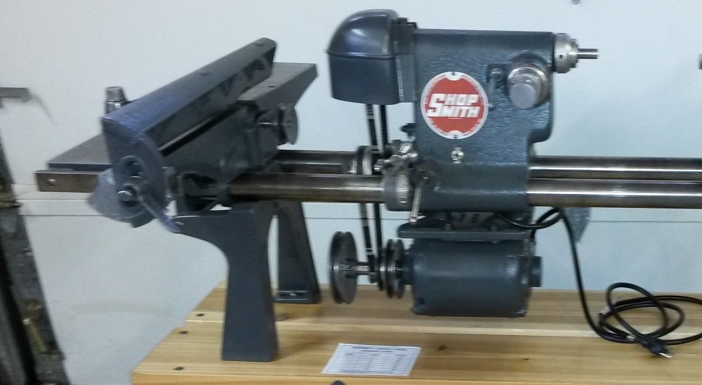

The Hinge Plate part number C 2719 that attaches between the jointer and the special Jointer Headrest does come up for sale rarely so you need to keep an eye out for one. It appears that the "ears" where the plate bolts to the jointer is the common spot they get broken. As for dust collection I now have a positional flex hose I plan to try next time I use the 4E jointer. It is Shopsmith P/N 556186 Stay-Put Dust Collection System. I believe it will work better than nothing and I can get it pretty close without touching the cutter head.
If you have not seen it elsewhere this is how the Model 4E Jointer looks mounted to the Model 10ER Shopsmith not including the belt to the Jointer.

Thanks for the photo and info, very helpful!
