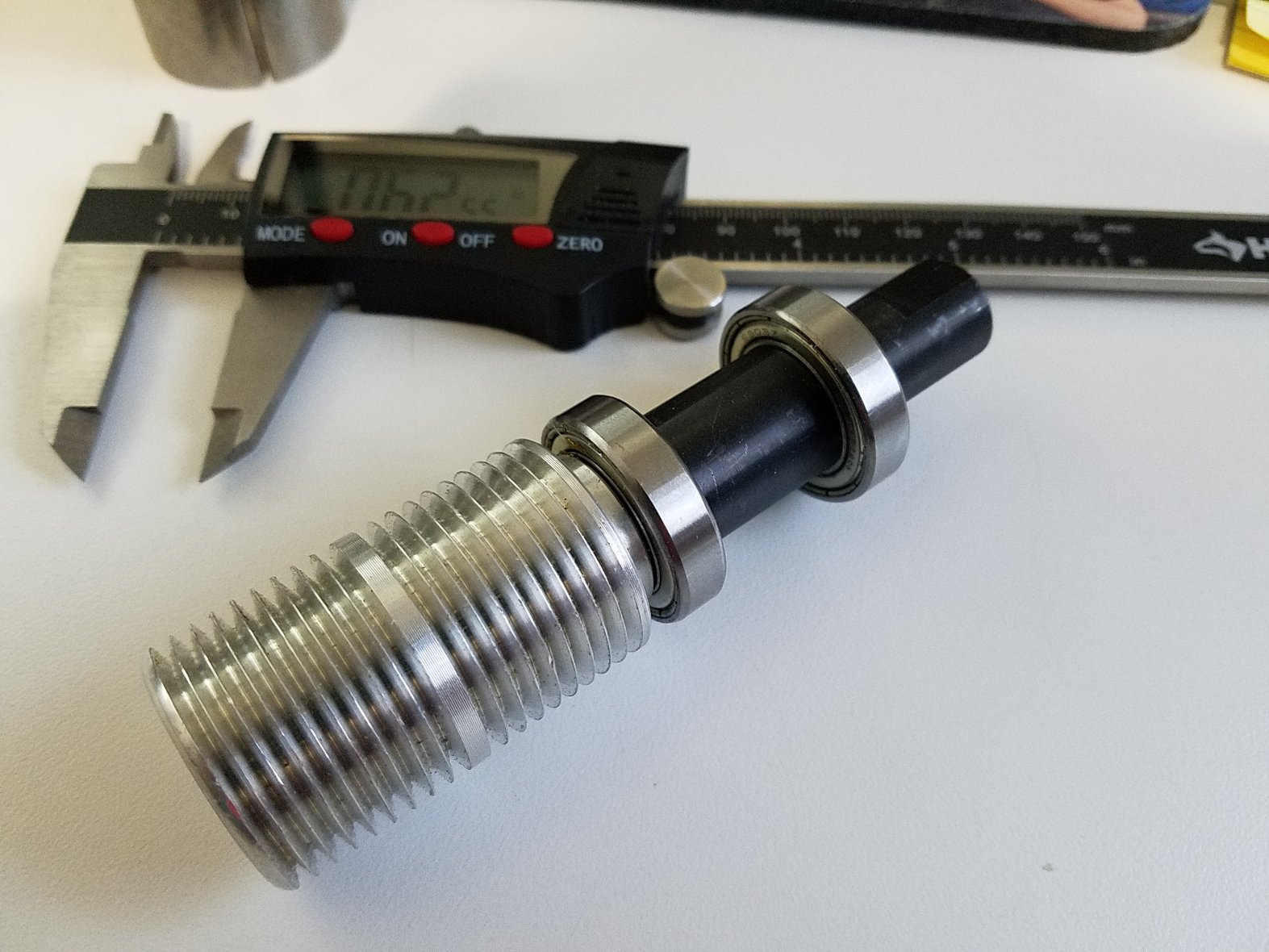

JPG wrote: Fri Jan 22, 2021 12:27 pm Us ignorant folks need pix!!!
I'm borrowing a pic from another thread referenced earlier, credit rjent:
shaft bearings for web.jpg (58.67 KiB) Viewed 1608 times
To my recollection, it was not clear or determined whether that is a spacer or just a larger diameter 'tween the bearings. Therefore not clear, at least to me, which direction the inner bearing is removed. But, my educated guess is that the pulley has to come off in order to remove the inner bearing, i.e. not a spacer.
- David
Re: Idler shaft bearing on the Power Pro???
Still no indication of how the pulley is secured to the shaft.
May be 'force' fit.
I am betting that the bearings are pressed on from opposite ends and that the pulley is pressed on after the bearing on that end
The diameter of the shaft is the same at both ends (.667") and the shaft between the two bearings is .750".
The two bearings are the same (6903Z) 17mm x 30mm x 7mm
