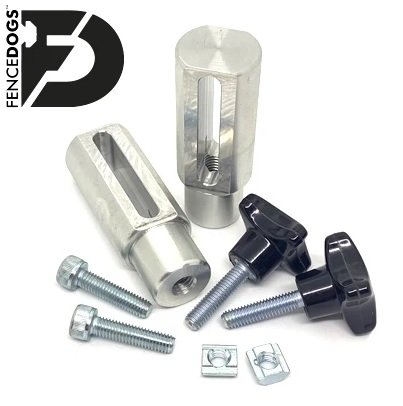

Thanks guys. I appreciate it. Once I can get things cleaned up a bit, I will try to post a picture of what I have and share it. To handle crosscuts on my custom MFT, I bought the Mk2 fence from Benchdogs in the UK. However, I don't really like the fit & quality of the benchdogs that come with it (see pic below). To gain more crosscut capacity, I want to try the Smart Connect Bench dogs, or something similar to semi-permanently attach the fence to my MFT top. The fence would be sitting on top of a row of dog holes rather than in front of them as would be the case with what they supplied me.
