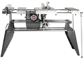

Since you already know how to add pictures to your post we encourage you do so. It helps in identifying parts and other things you may have questions about. Besides we love seeing pictures. As David has already touched on Mark 5/V's had serial numbers prior to December of 1987. After that the serial number listed on the Shopsmith tools are a date code. As for the Model you have they are all upgradable so what it started out as may not be the model equivalent it is now. All Mark V models have the same Bench, Tailstock and Headstock. The difference is the Table System which also includes the carriage. The Mark V 500 is the original table system that dates back to the introduction of the Mark 5 in 1954. A Mark V 500 is shown below.
_ _
With the introduction of the Mark V 510 and 505 in 1985 the original Mark V became the Mark V 500. The Mark V 510 & 505 introduced the larger table system and with the 510 floating tables and connector tubes thereby expanding the table surface. The 505 did not come with the 2 floating tables, connector tubes or the support legs. Those could be added later. Below is a picture of a Mark V 510.
_ _
In 1999 Shopsmith introduced the Mark V 520 with the Pro Fence system. It is a 510 with extruded aluminum rails instead of the fence rail tubes of the 510 & 505 and a new fence. Again upgrades for the 500, 505 & 510 were made available to make them a 520. Below is a picture of the Mark V 520.
_ _
