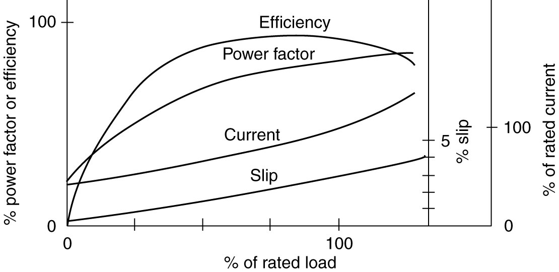

No worries about disagreeing with me, David! I merely “suspected” that most of the 0.44 hp losses were in the transmission. Sorry for the delay in responding, but it’s been an unusually busy week.
I don’t think that either of our experiments are conclusive regarding where the no-load losses are happening. I had the equipment on hand (at the time) to measure true input power. But I didn’t test the motor unbelted, so I could only measure total losses. You did measure the motor unbelted, but did not have the requisite equipment to measure true input power.
The graph below shows why a current measurement alone doesn’t tell much about no-load motor input power. The electrical power factor is small, meaning that the motor current is roughly 90 degrees out of phase with the applied voltage, and thus the true electrical power is small. As the load increases, modestly, the power increases primarily due to the power factor increasing. The motor current doesn’t change very much, as you verified in your experiments.
Sources of power loss in such a system include resistive losses in the motor windings, magnetic hysteresis losses in the motor iron, motor-bearing losses (minimal), and motor cooling-fan losses (significant) before we even get to the motor output shaft.
So why did I suspect that most of the power losses are in the transmission, rather than in the motor itself? It’s not very scientific, actually. In my experience, an induction motor running with nothing attached to the output shaft doesn’t get very warm. But an unloaded Shopsmith headstock does get a bit warm, even though it has considerably more surface area to dissipate heat.
But now that you’ve made me think about it, that could be largely due to better heat dissipation of the motor cooling fan in free air. And the graph says that the motor efficiency goes all the way down to diddly-squat at no load. So now I don’t think we have enough data to say, one way or the other.
