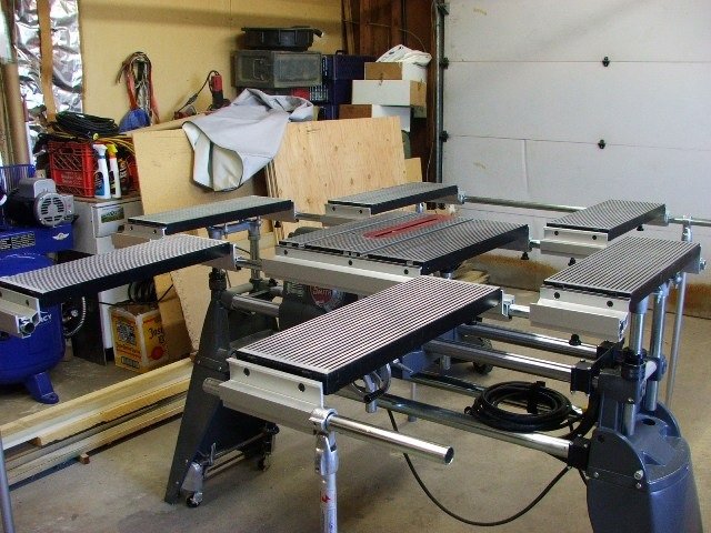

For the extension tables for infeed/outfeed support, etc. below is a good picture to show what is possible (jsburger's pic from thread linked below). This gives you a good idea of how you can support sheets of plywood, slabs of lumber, etc. An alternative way of connecting these extension tables is the Extension Table Brackets (https://www.shopsmith.com/ownersite/cat ... racket.htm and pics 4 & 5 below) from Shopsmith which I like. You can buy as many extension tables as you want, but realize all of these need leg supports and connecting rods, etc. Second picture (post from larryhrockisland) below gives you a better idea of what bevel cuts are like on a long board. This 2nd picture is a Mark V (model 500). Only Mark V (model 510 and 520) and the newer Mark 7 have tables with rails that can be linked to extension tables. Both the 510 and 520 have the same size table which is larger than the 500 table. The difference between the 520 and the 510 is that the 520 uses beefier aluminum extrusions versus round rails (see 3rd pic below for 520 fence). With these new 520 rails, there is a big fence that works better than the 510 fence for many of us, though some still prefer the 510 fence. Unfortunately, the 510 and 520 table systems are not compatible, i.e. you can't easily mix & match extension tables with each. Crosscuts sleds work fine on the Shopsmith as long as they are custom built or offered by Shopsmith. If you are bringing a crosscut sled from a regular tablesaw to the Shopsmith, it may be too deep of a crosscut sled. It is not that you can't use it, but that if too deep it may be more awkward to start the sled on the smaller Shopsmith table for the cut. Also, realize that the Shopsmith miter slots are slightly undersized. Most tablesaws are 3/4" x 3/8" miter slots, but Shopsmith slots are 23/32" x 5/16" so if you are bringing crosscut sleds from another tablesaw you will likely need to replace the miter bars on them to fit a Shopsmith. When it comes to plywood I still recommend a tracksaw for the initial breaking it down. After this you can use your Shopsmith for cutting smaller pieces. I think I have seen tracksaws as cheap as like $250, but to get one from the top 3-4 brands is like $400-500. Note on tracksaws that if you want any aftermarket alignment guides that they only fit on the top brands which are somewhat interchangeable.
viewtopic.php?t=16342
viewtopic.php?f=5&t=23472&p=269032&hili ... rt#p269032
